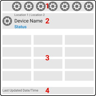

Single Priority Feature Layout
  1. Status Feature List
  2. Device Information and Priority Feature Status
  3. Priority Feature Controls
  4. Device Last Updated Date/Time
How is the primary feature determined?
Currently, the primary priority feature is determined automatically based on the configuration of the device and the number different types of features associated with the device.
  • When there is only one feature with controls, that feature is used as the primary feature.
  • When there is only one feature with statuses that is not a battery or central scene feature, that feature is used as the primary feature.

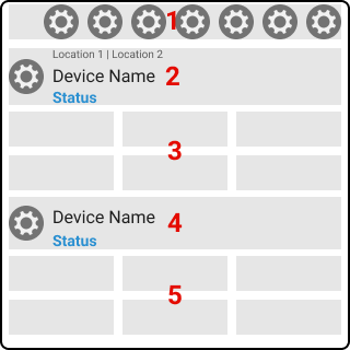

Multi-Control Layout
  3. Primary Priority Feature Controls
  4. Secondary Priority Feature Status
  5. Secondary Priority Feature Controls

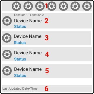

Multi-Status Layout
  3. Secondary Priority Feature Status
  4. Tertiary Priority Feature Status
  5. Quaternary Priority Feature Status
  6. Device Last Updated Date/Time

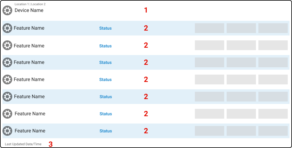

List View
A secondary view is available for power users that displays devices in a list format.  In this view, device features are all displayed separately to give you an in-depth look at all of the components for each device.
  1. Device information
  2. Feature information including status and controls
  3. Device last updated date/time
