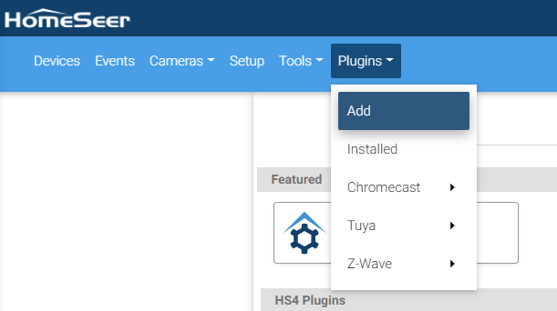

  1. Navigate to Plugins > Add to get to the HS4 plugins list. Here, you will see a list of featured plugins and you may also search for a desired plugin.
