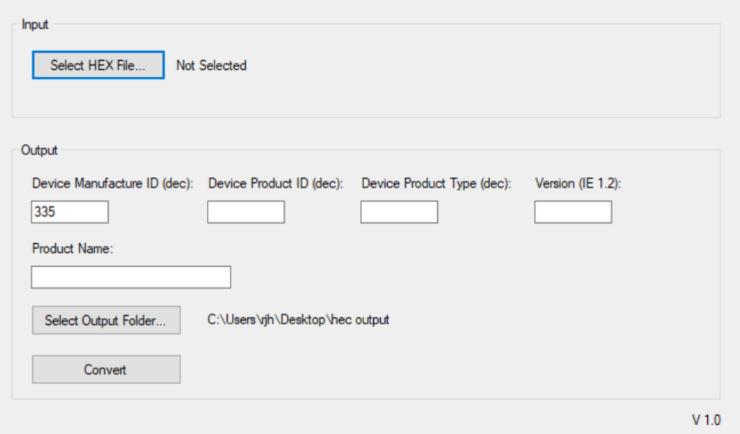

Encrypting Files
If you would like your HEX files encrypted, contact HomeSeer and request a copy of the HECEncrypt.exe encryption tool. This tool will take an intel HEX file and encrypt it to a "HEC" file which Z-Flash can read.
To use this tool:
Make sure your system has .NET 4.6 or later installed, then run the EXE.
  1. In the Input section, select the .HEX file or .OTA file you want to encrypt.
  2. In the Output section fill out the manufacturer ID, Device Product ID, Device Product Type, and the firmware version number.
  3. Select an output folder, maybe on your desktop. This output folder will hold all the sub folders, one for each update.
  4. Click on the "Convert" button to encrypt the file, create the named sub folder, and write the file.
    The tool will automatically format the output folder for you as well as the proper format of the new .HEC file.
  5. Now simply copy the subfolder to your Z-Flash updates folder. You may zip up your folders and email them to support@homeseer.com and we will include them with the application.
