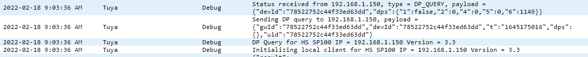

  6. From Tools > Log, look for the 4 lines similar to the ones below that match the local IP Address of your device. Copy and paste those lines to a temporary text file

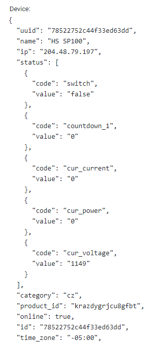

  7. From Devices, click on your device and go to the Tuya tab, then scroll down to the Device section image2022-2-18_9-18-29.png

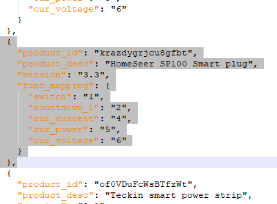

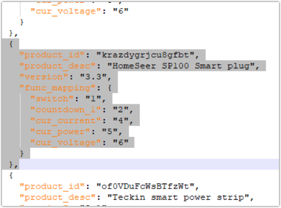

  8. Edit  Data/Tuya/UserLocalApiProducts.json and add a product like on the screenshot below. The difference between LocalApiProducts.json and UserLocalApiProducts.json is that LocalApiProducts.json is overwritten when the Tuya plugin is updated or reinstalled, so your changes should be in UserLocalApiProducts.json.
    1. product_id must be the one you found at step 7
    2. product_desc should be a description of your device brand and model
    3. version must be the one found  at step 6
    4. func_mapping must be a list of status code found at step 7 and the values for these codes must be the ids of the dps list found at step 6. For example my dps list found at step 6 is "dps":{"1":false,"2":0,"4":0,"5":0,"6":1173}, so I match "switch" with "1", "countdown_1" with "2", "cur_current" with "4", etc. Most probably the codes from step 7 and the ids from step 6 will be in the same order, but you can also double check that the values reported for code/ids in step 6 and 7 are the same, for example we can see that both cur_voltage code from step 7 and id #6 from step 6 report the same value of 1149
      Be careful about the braces, commas and quotes, so that end result is a valid JSON file.

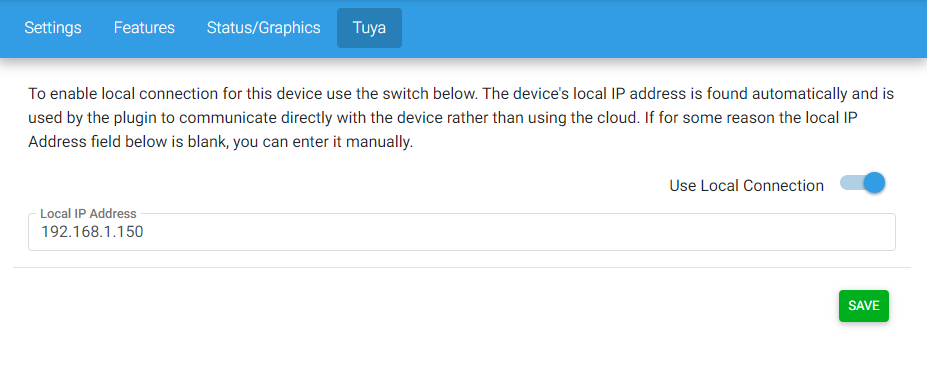

  10. From Devices, click on your device and go to the Tuya tab, you should now see something like the following screenshot:

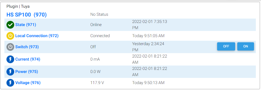

  11. Enable the Use Local Connection switch and Save, then go back to Devices, you will see a new "Local Connection" feature that should have its status set to Connected
    To make sure the local connection works as expected, go to Tools > Log and you should see these kind of Ping/Pong messages every 10 seconds:
  12. If everything works as expected, you can remove the "send_dp_query=True" line from the Tuya.ini file, and set the "Log Level" back to Info.

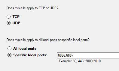

  3. Select Inbound Rules in the left pane and then click New Rule... in the right pane. The New Inbound Rule Wizard will pop up.
  4. Click the Port radio button, then click Next
  5. Click UDP, then type 6666, 66677 into the Specific local ports: field, then click Next
  6. Click Allow the connection, then click Next
  7. Leave the the Domain, Private and Public rule options checked
  8. Name the rule Tuya Inbound Ports and click Finish

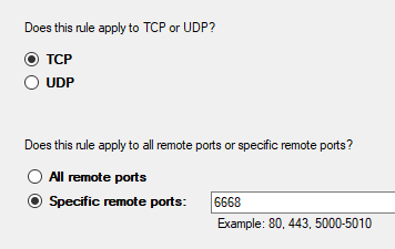

  9. Now, repeat the process but create an Outbound Rule instead for TCP port 6668
  10. Name this one Tuya Outbound Port and click Finish
