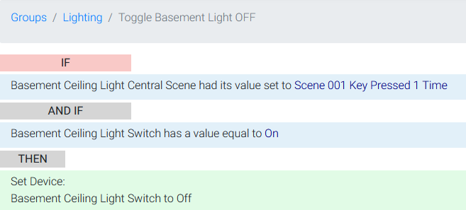

Two Events would be required to implement Toggle Operation for any given HomeSeer switch. These events will control a "Basement Ceiling Light", referred to as Device XXX in the description below.
Event #1
Event #2
Trigger: Pressing the bottom paddle once = (Device XXX) Central Scene 002 Key Pressed 1 Time
Condition: Load is Off = (Device XXX) has a value equal to Off
Action: Turn Load On = Set Device (Device XXX) to On
Trigger: Pressing the top paddle once = (Device XXX) Central Scene 001 Key Pressed 1 Time
Condition: Load is On = (Device XXX) has a value equal to On
Action: Turn Load Off = Set Device (Device XXX) to Off
