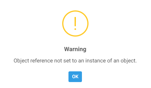

Older HomeTroller Pro systems may not be able to load Zigbee2MQTT. If you are experiencing this issue you will see the warning below when attempting to start Zigbee.

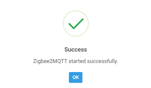

  5. Turn on the Zigbee Plus plugin and start Zigbee2MQTT from Plugins > Zigbee Plus > Zigbee2MQTT Back-End
