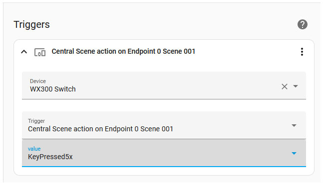

Multi-tap Triggers
Automations may be triggered by pressing the WX300 top or bottom paddle up to 5 times. Select the Central Scene action on Endpoint... trigger and choose Scene 001 for the top paddle or Scene 002 for the bottom paddle. In the example below, the trigger fires on the top paddle being pressed 5 times.

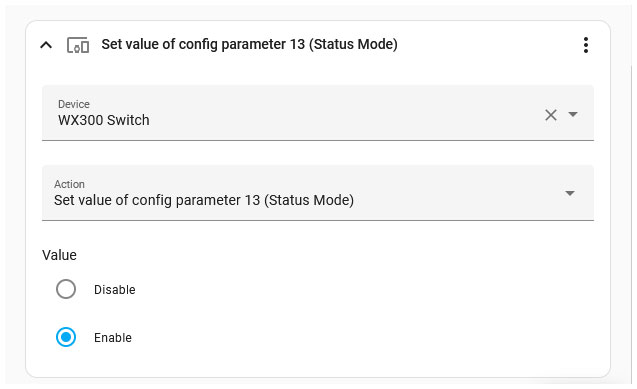

  1. Enable Status Mode for the switch. By default, this mode is disabled to allow the switch to display the load value.

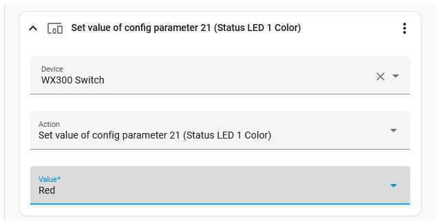

  2. Choose which LED you wish to light and what color you wish to use (1=bottom LED, 7=top LED). Colors are Red, Green, Blue, Magenta, Yellow, Cyan, White and Off.

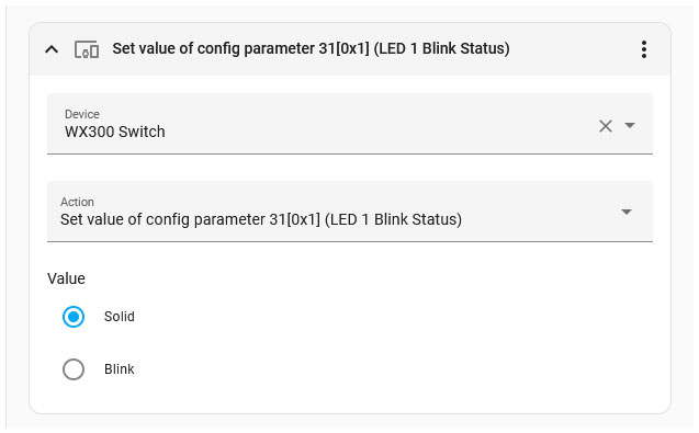

  3. Choose whether the LED should blink or glow
Enable Status Mode*
Choose LED & Color
Set LED to Blink or Glow

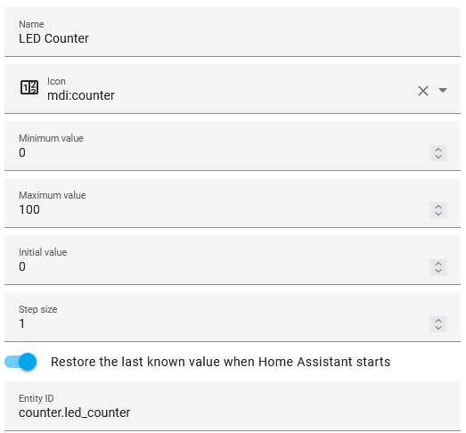

  1. In Home Assistant, create a counter with these values.

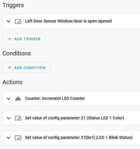

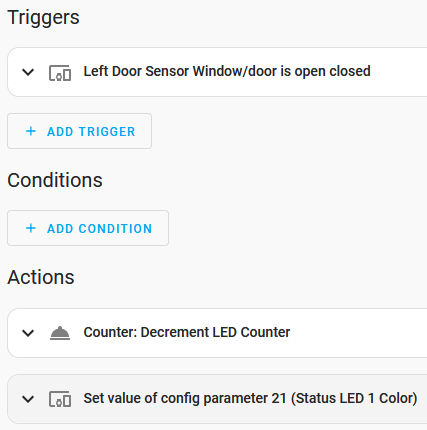

  2. Add actions to Increment or decrement the counter to automations that turn status LEDs On or Off
    Increment Counter when Commands Turn LEDs On
    Decrement Counter when Commands Turn LEDs Off
    This automation also includes actions to turn LED on
    This automation also includes action to turn LED off

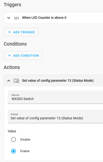

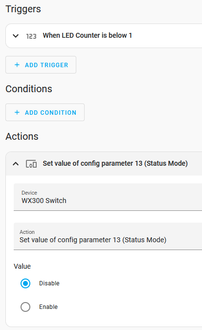

  3. Create 2 automations; 1 to enable status mode when the counter is greater than 0, 1 to disable status mode when the counter is less than 1.
    Enable Status Mode when Counter is Above 0
    Disable Status Mode when Counter is Below 1
