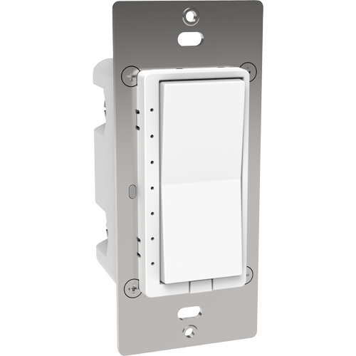

HS-WX300
HS-WX300
HS-WX300 replaces the HS-WD200+ and includes many new improvements. This document will highlight the differences between these products.

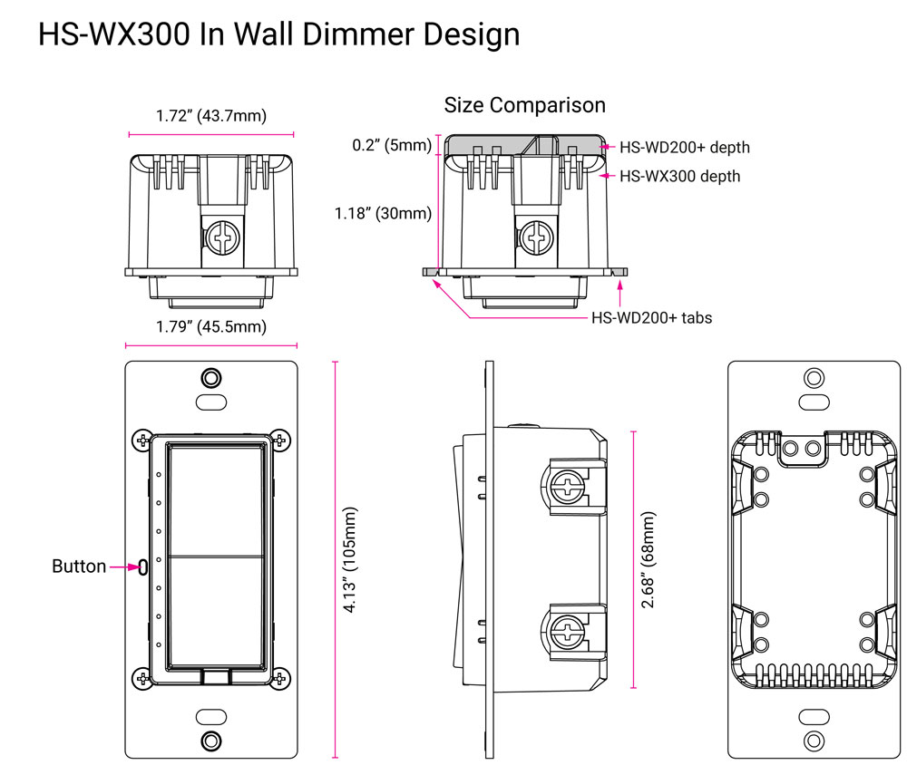

Physical Size
https://forums.homeseer.com/filedata/fetch?id=1498220&d=1632420550
https://forums.homeseer.com/filedata/fetch?id=1498221&d=1632420600
HS-WD200+
This model can be installed into most common modern electrical boxes. The yoke includes tabs that must be removed for installation into multi-switch gang boxes.
HS-WX300
This model is physically smaller (less deep) which allows it to be installed into older smaller electrical boxes. The yoke is also physically smaller and does not have tabs. This makes it easier to install into multi-gang boxes.
