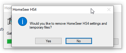

Windows
  1. Uninstall the beta. Do not remove HS4 settings and temporary files.
  2. Install the previous version.
  3. Launch HS4 and navigate to Setup > General and click Edit Config
  4. Select the config file that was created when the beta was installed. The name will contain _before_4.2.x.x.json
  5. Check your events to confirm they're all there and the actions are correct

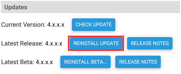

Linux
  1. Navigate to Setup > General and click REINSTALL UPDATE
  2. Once installation is complete, navigate to Setup > General and click Edit Config
  3. Select the config file that was created when the beta was installed. The name will contain _before_4.2.x.x.json
  4. Check your events to confirm they're all there and the actions are correct
