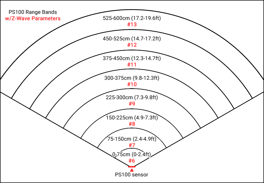

PS100 includes many settings which can be adjusted using Z-Wave parameters (see table below). The most important setting controls the sensitivity of the 8 different distance ranges illustrated in the diagram below. The following values may be set independently for each range: 0 = disabled (no detection), 1 = low sensitivity, 2 = med sensitivity, 3 = high sensitivity.
Depending on performance, it may be necessary to increase sensitivity to improve detection at greater distances while reducing sensitivity at closer distances. It may also be necessary to reduce or disable sensitivity in ranges where fans, filters or other appliances may cause false detections. Some experimentation may be required.

Range 0-75cm (0-2.4ft) Sensitivity
0-100 where 0=disabled and 100 is most sensitive
50
7
Range 75-150cm (2.4-4.9ft) Sensitivity
50
8
Range 150-225cm (4.9-7.3ft) Sensitivity
50
9
Range 225-300cm (7.3-9.8ft) Sensitivity
50
10
Range 300-375cm (9.8-12.3ft) Sensitivity
90
11
Range 375-450cm (12.3-14.7ft) Sensitivity
90
12
Range 450-525cm (14.7-17.2ft) Sensitivity
90
13
Range 525-600cm (17.2-19.6ft) Sensitivity
90
