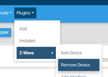

  1. Navigate to Plugins > Z-Wave Plus > Remove Device.

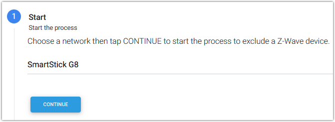

  2. In the Start step, select the Z-Wave Network you wish to remove a device from and click CONTINUE.

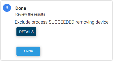

  4. Once exclusion is done, click the FINISH button and you’ll be taken to the devices page.
