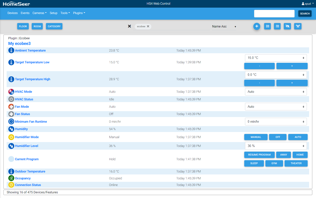

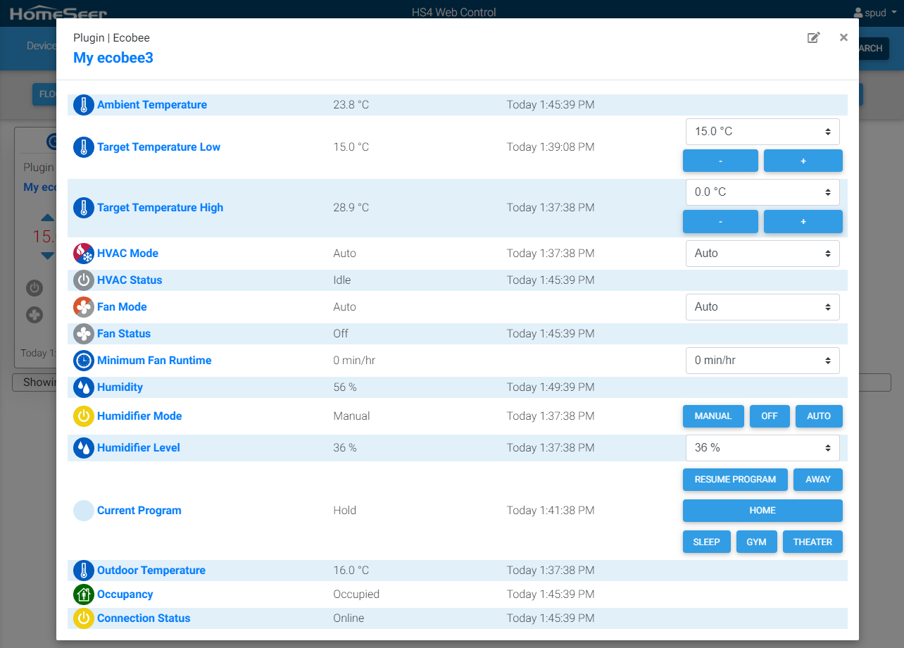

  • Allows HomeSeer to read ambient temperature, target temperatures, humidity, HVAC status and mode, Fan status and mode, etc...
  • Allows HomeSeer to control target temperatures, fan, humidifier, current program etc..

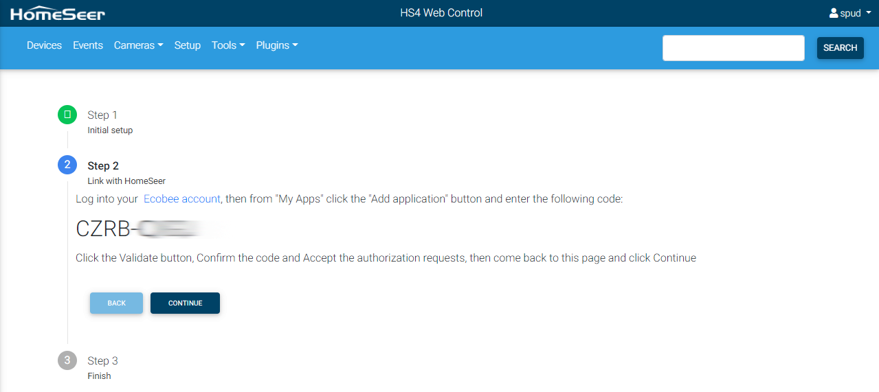

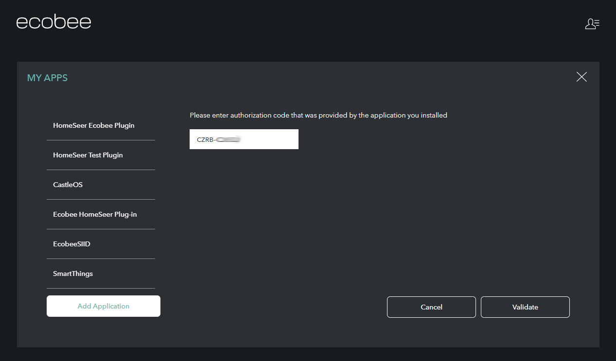

  1. Go to Plugins > Ecobee > Authorize and start the authorization process
  2. Log into your Ecobee account at https://www.ecobee.com/ and then from "My Apps" click the "Add application" button and enter the code provided in the Authorize page
  3. Validate then come back to the Authorize page and click continue

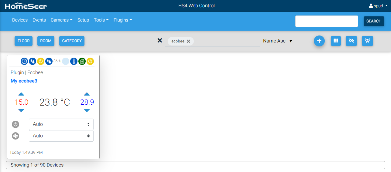

  4. If everything is ok, the plugin will create one device for each of your thermostat and one device for each of your Smart Sensor.

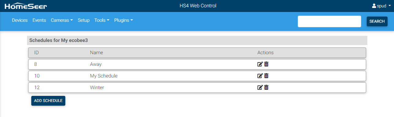

Ecobee Schedules page

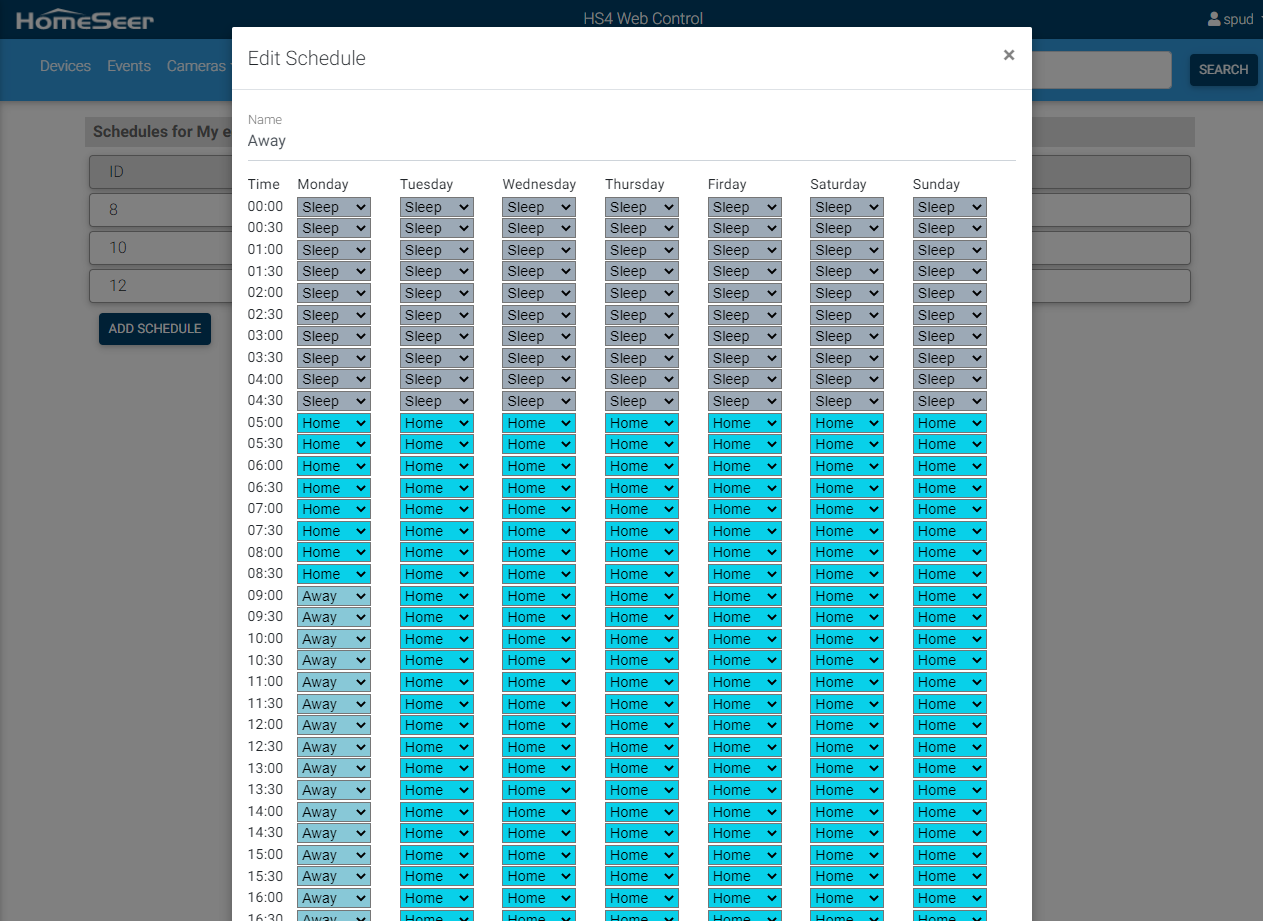

  • This page allows to manage (create, edit, and delete) thermostat schedules. The Ecobee thermostat and app only handle one schedule, but here you can create several ones and set the one you want on your thermostat using the "Set Schedule" event action.

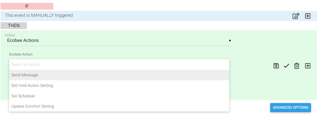

  • The plugin has 4 specific event actions that can be found under the "Ecobee Actions"
    • Send Message: allows to display some text messages on your Ecobee thermostats
    • Set Hold Action Setting: allows to change the Hold setting from an event

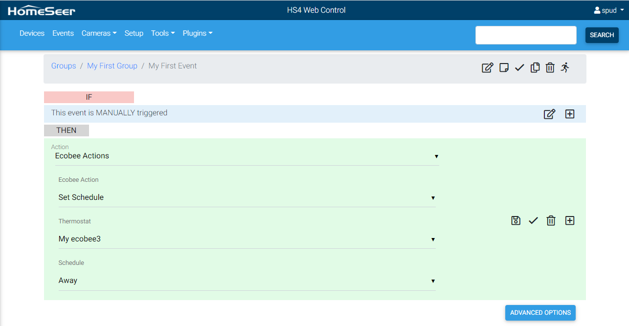

    • Set Schedule: allows to change the current schedule on your thermostat
    • Update Comfort Setting: allows to change the Heat and Cool setpoint of an existing "Comfort Setting"

Ecobee Screen
Device List View
Device Grid View
Device Features
