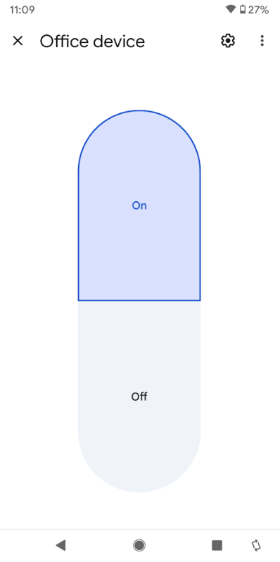

  1. After adding the device to the Google Home App, long press the device to display the device control screen.

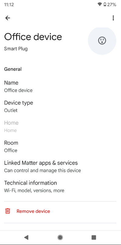

  2. Click on the gear in the upper right corner to display the device settings.

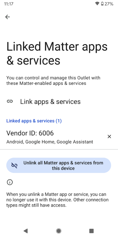

  3. Click on “Linked Matter apps & services” to display the “Linked Matter apps & services” page.

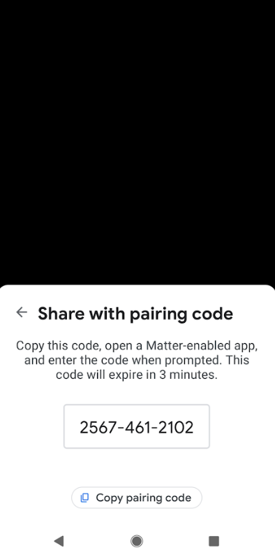

  4. Click on “Link apps & services”. A dialog will display, select “Use pairing code” and the following screen will appear that reveals a pairing code:

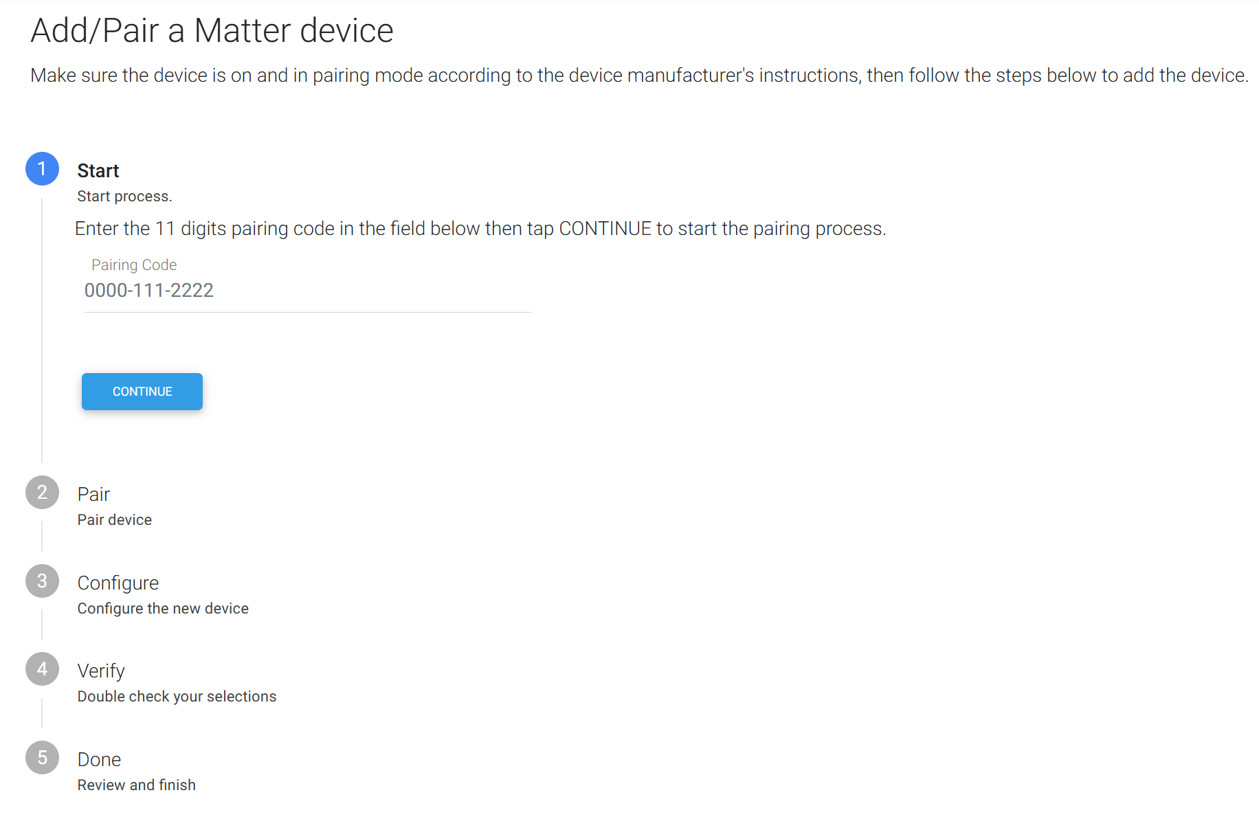

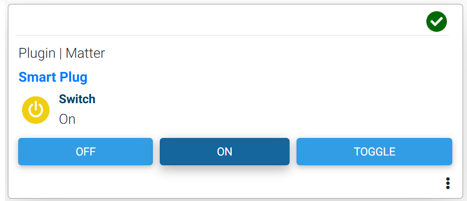

  5. In HomeSeer, select the Plugins menu, then “Matter Controller” then “Add Device”. Enter the pairing code you received in the Google Home App. The dashes are not required and can be omitted.
  6. Click continue to finish adding the device. The device will now be controllable from HomeSeer.

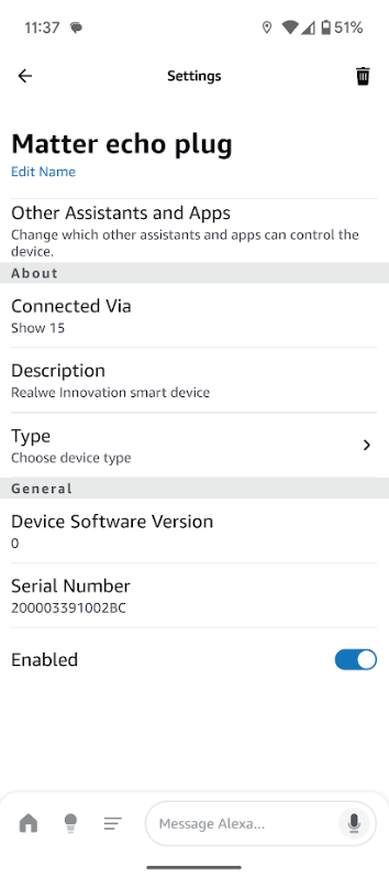

Adding Amazon Alexa Devices
The procedure for adding an Amazon device is similar to Google. First add the device to the Alexa App on your phone then follow this procedure to add the device to HomeSeer.

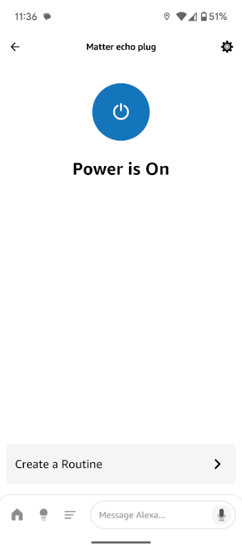

  1. Click on the device in the Alexa App to display the device control screen.

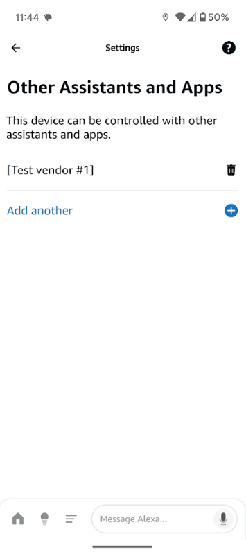

  2. Click on the gear in the upper right corner to display the device settings, then click on “Other Assistants and Apps”.
  3. Click on “Add Another” if this is the first time adding a device to HomeSeer.

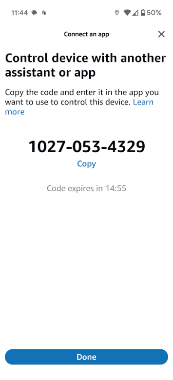

  4. A screen displays with a code, you will now enter this code into HomeSeer as in step 5 under “Adding Google Home Devices” above. The device will be controllable from HomeSeer.

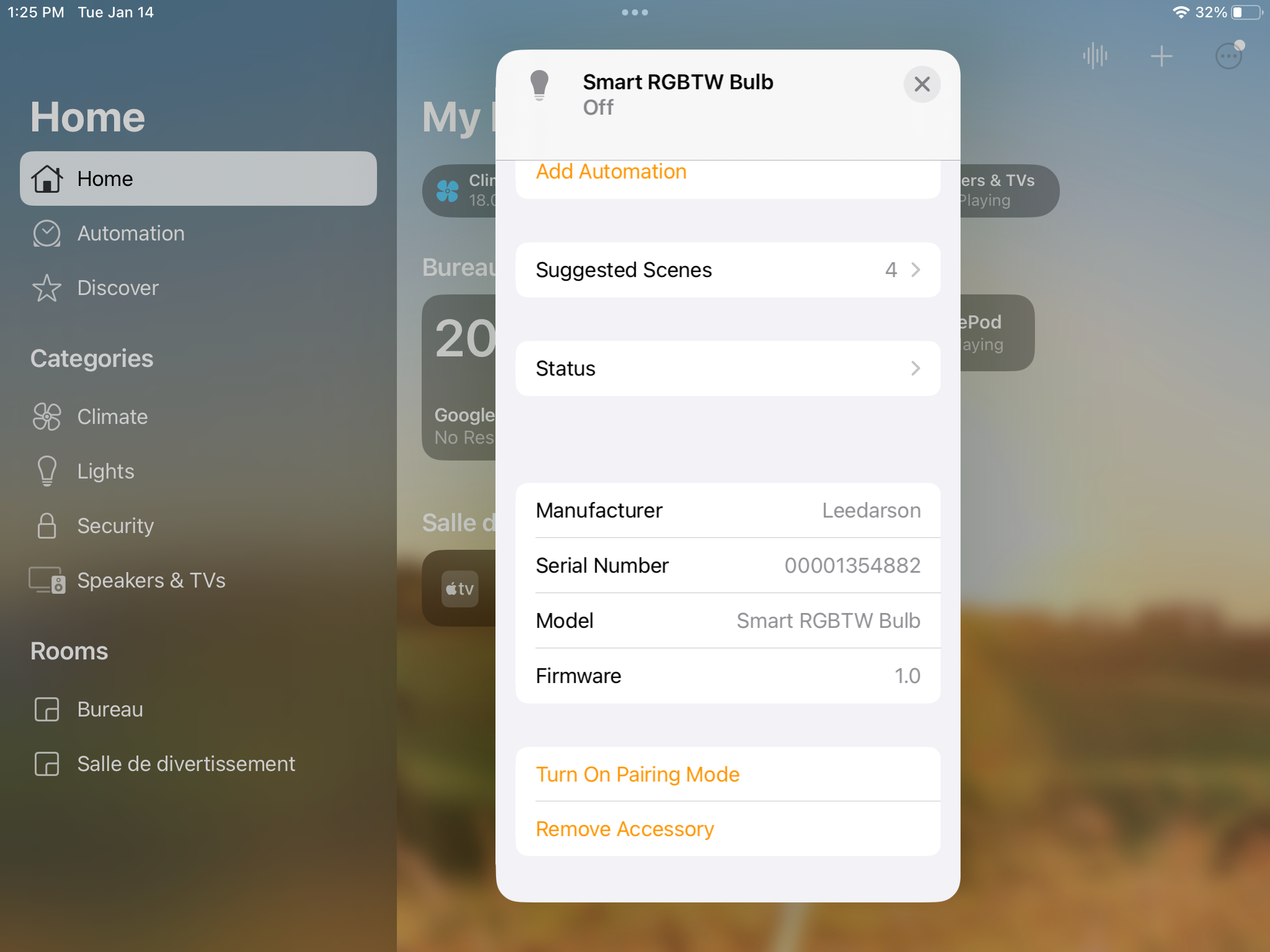

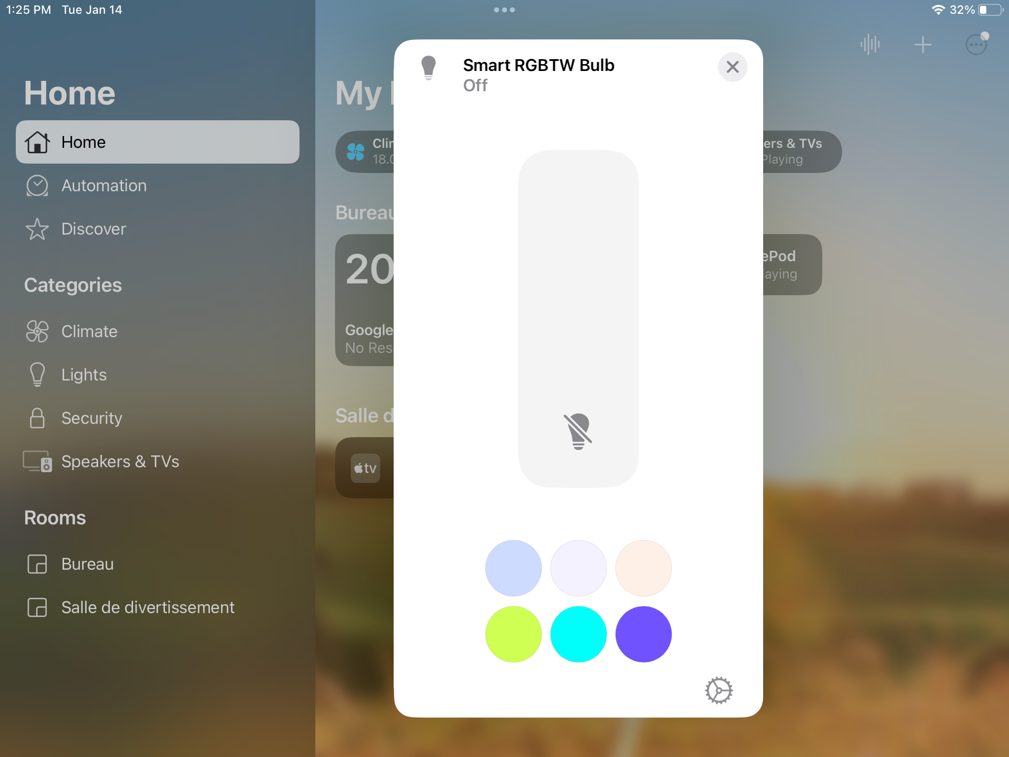

  1. Click on the device in the Home App to display the device control screen.
  2. Click on the gear in the bottom right corner to display the device settings. Then click on “Turn On Pairing Code“

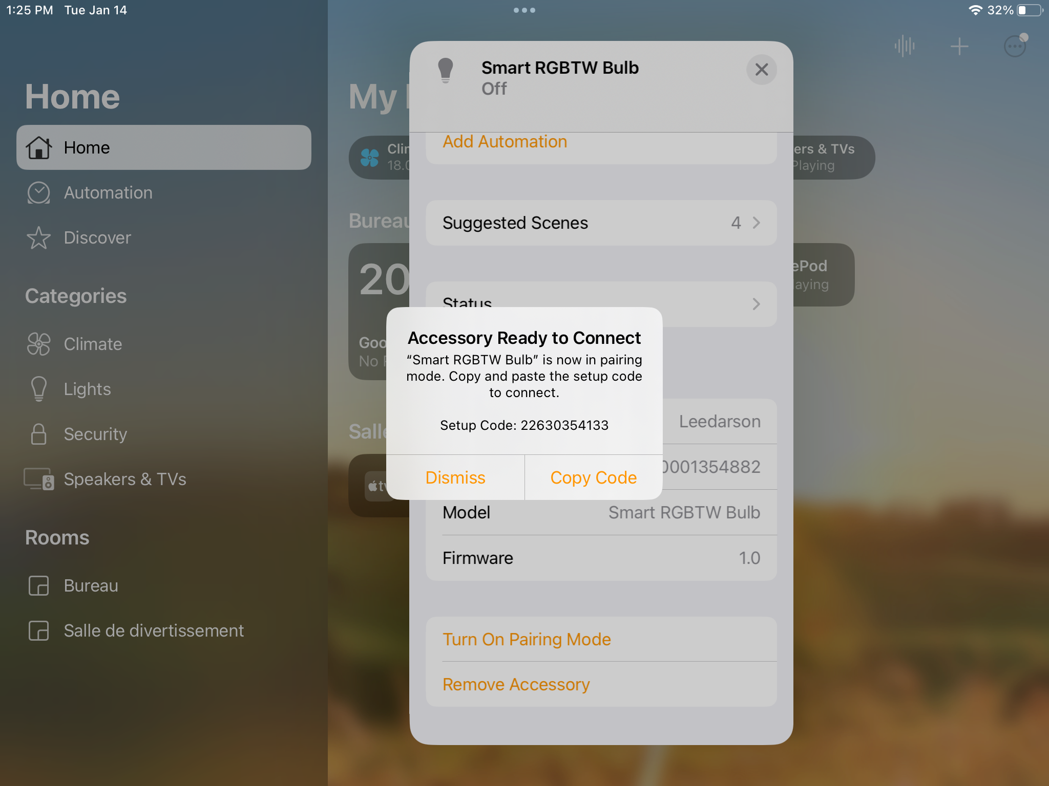

  3. A popup with a setup code displays. You will now enter this code into HomeSeer as in step 5 under “Adding Google Home Devices” above. The device will be controllable from HomeSeer.
