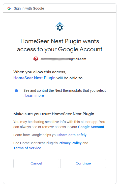

  1. Go to Plugins>Google Nest>Authorize and start the authorization process.

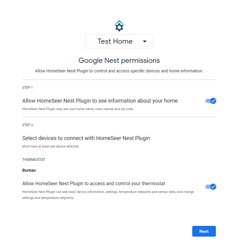

  2. Log in with the google account where the thermostat is configured and allow "HomeSeer Nest Plugin" to access and control your thermostat:

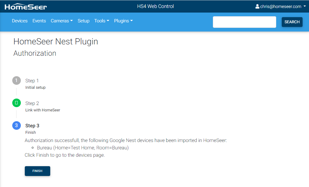

  4. You will be redirected to the Google Nest plugin Authorize stepper you just left, and it will bring you to the final step.

Google screens related to adding nest devices to HS4:
image2022-10-10_11-32-59.png image2022-10-11_14-8-28.png image2022-10-10_11-40-54.png

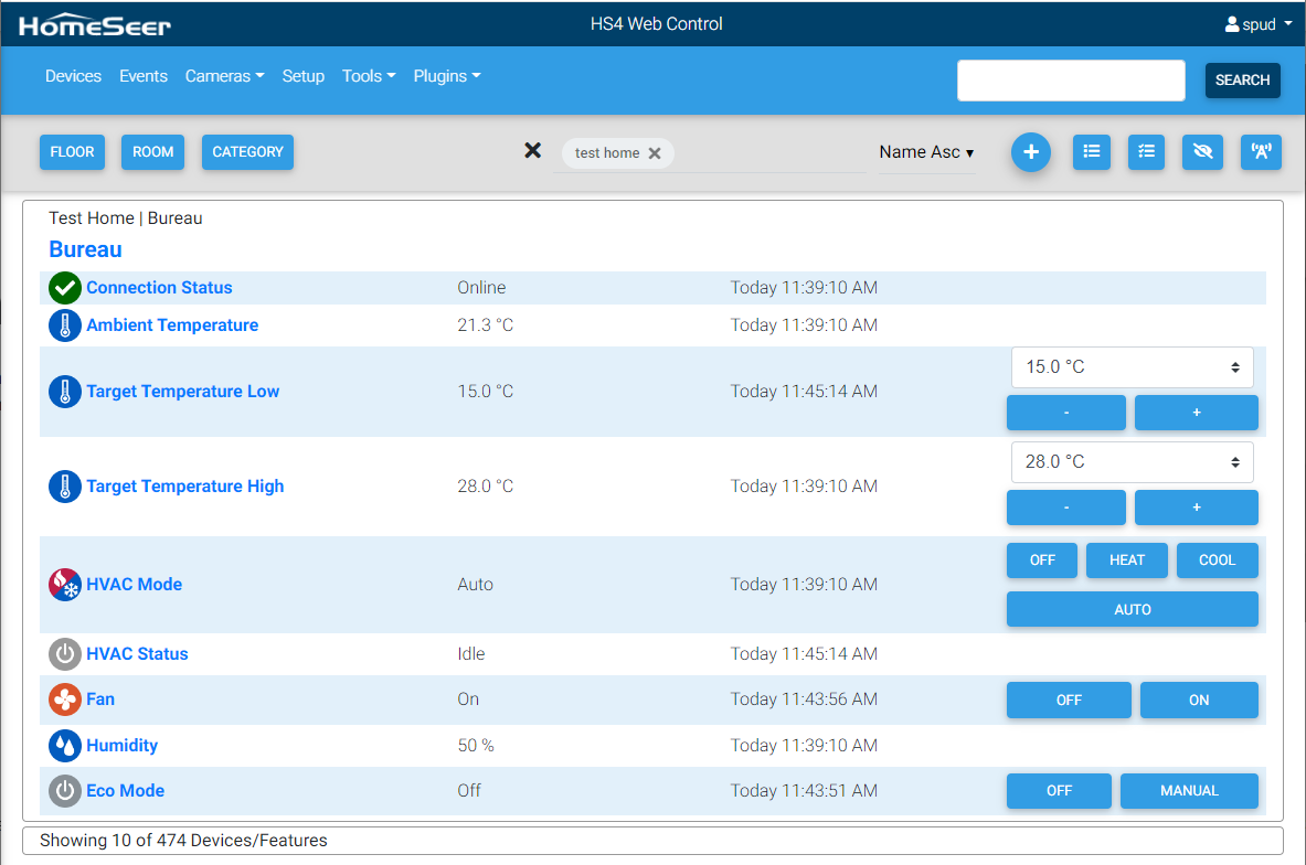

Nest Devices in HS4
List View

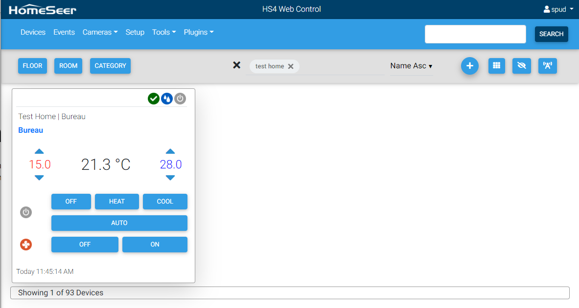

Grid View

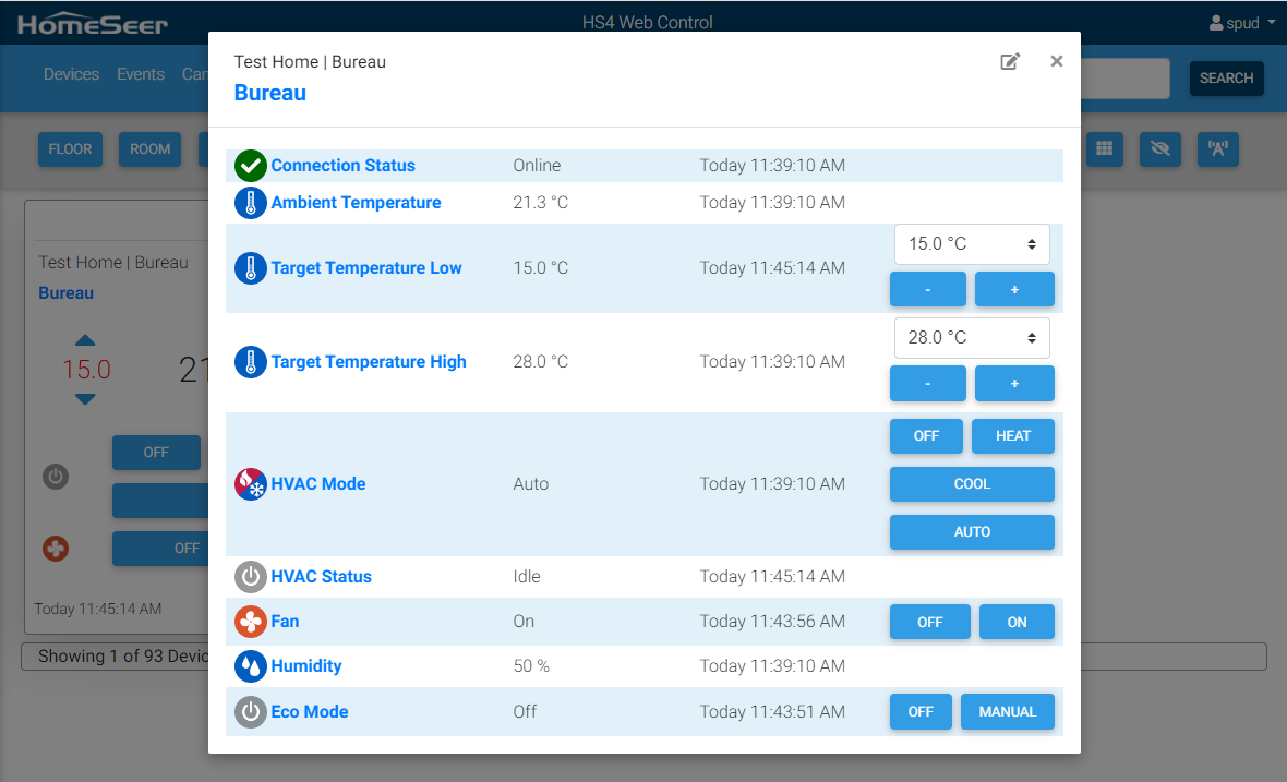

Device Features
