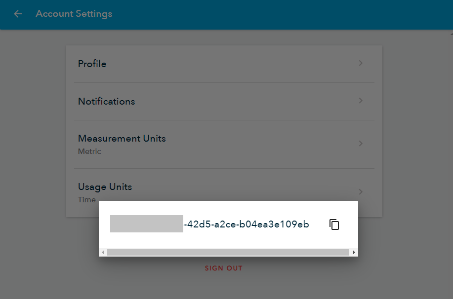

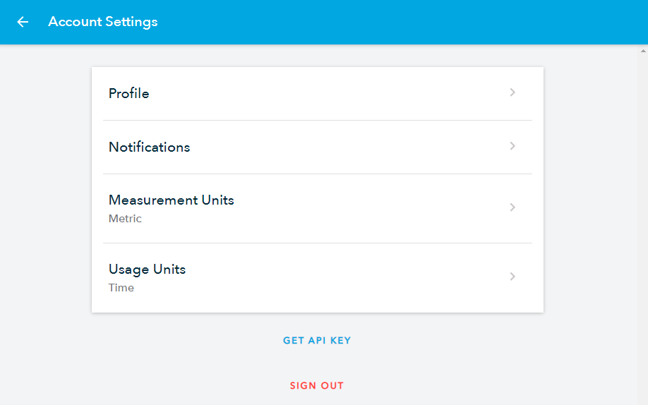

  1. Go to Plugins > Rachio > Authorize and follow the instructions.
  2. You will have to log into your Rachio account and get an API key that you must enter at step 3.
  3. If everything is ok, the plugin will create one device for each controller linked to your account, and one device for each watering zone.

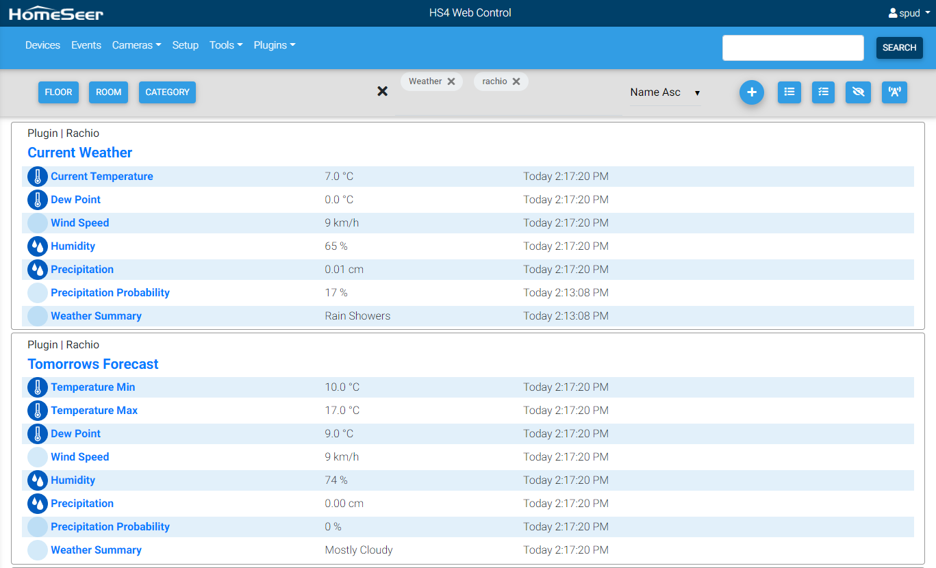

You select the number of days you want the forecast for, and the plugin will create one device for the current weather and one device for each day forecast (Tomorrow's Forecast, 2 Day Forecast, 3 Day Forecast, etc...)

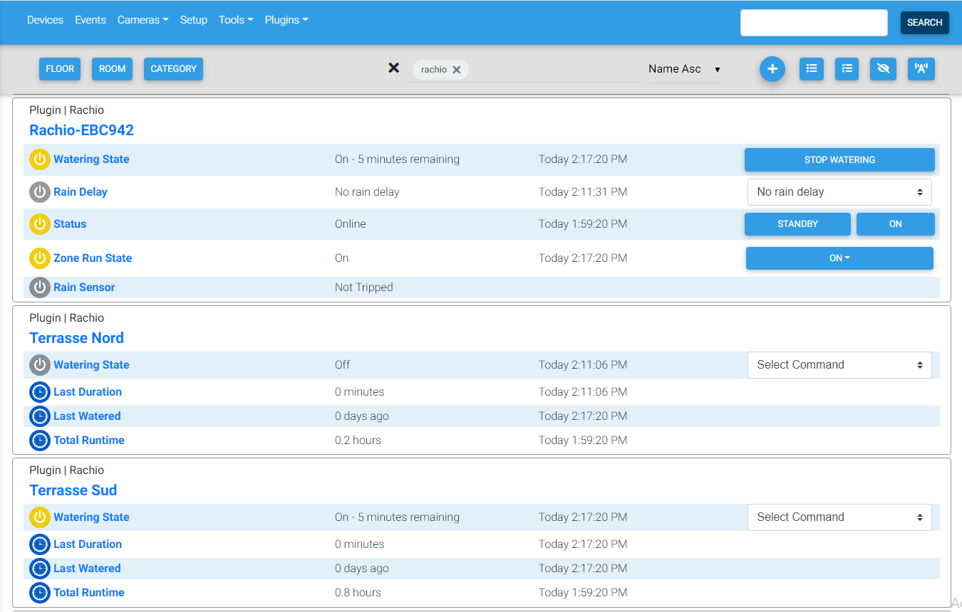

Adding Rachio Controllers

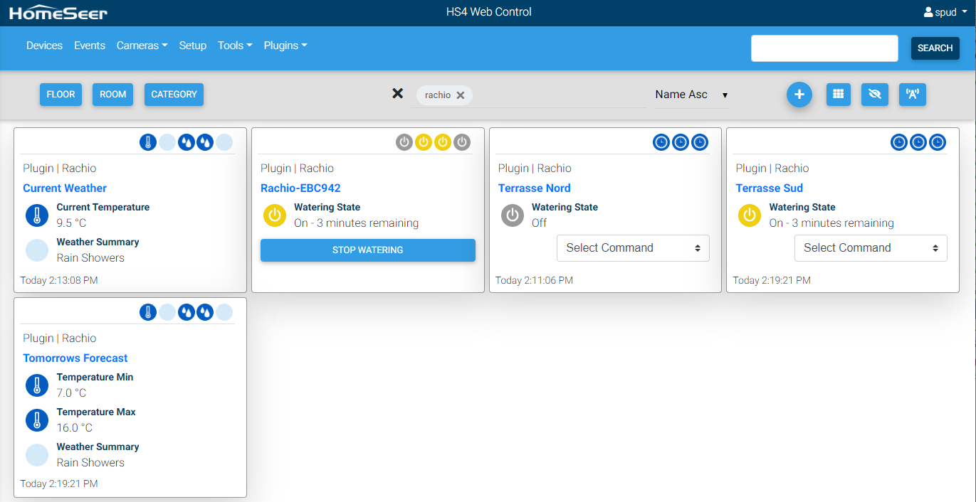

List View
List View 2
Grid View

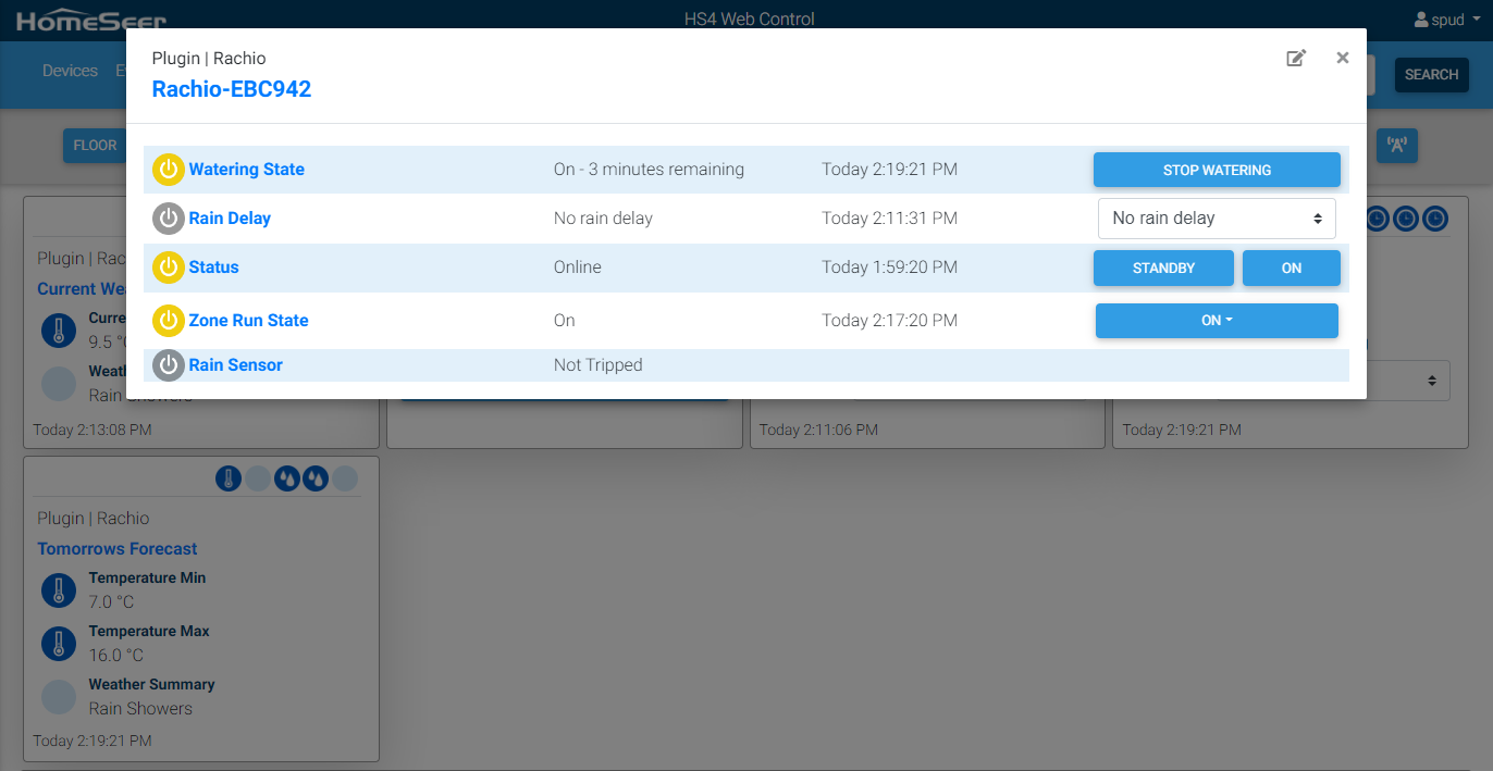

Device Features
