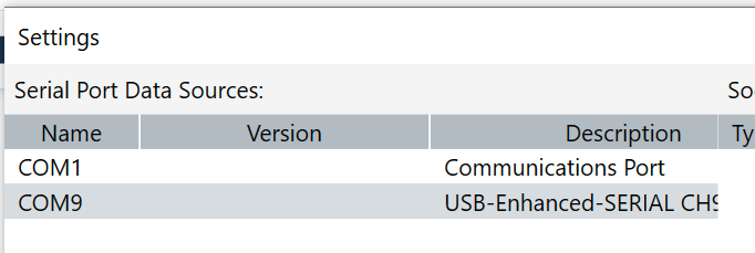

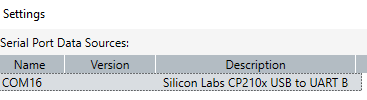

  5. Click the settings button (with gear icon), then select the COM port that’s associated with your SmartStick:
    • For SmartStick G8, the description will be "USB-Enhanced-SERIAL CH9102"
    • For SmartStick G3, the description will be “Silcon Labs CP210x USB…”

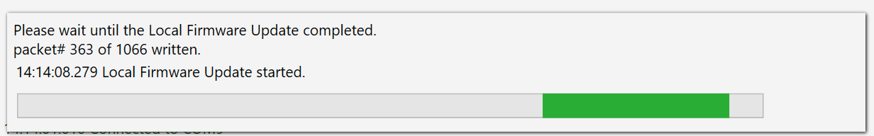

  6. Click the OTW Firmware Update button.
  7. In Windows file explorer, locate the firmware file (ending with .gbl), select it, then Open it. This will begin the update process.
  8. When done, this message will appear at the bottom of the screen: "Connected to COMX after Firmware Update to Z-Wave X.XX"
Your SmartStick is now updated to the new version and may be used with the compatible software of your choice.
