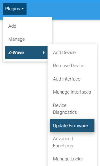

  1. Navigate to Plugins > Z-Wave Plus > Update Firmware.

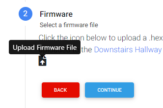

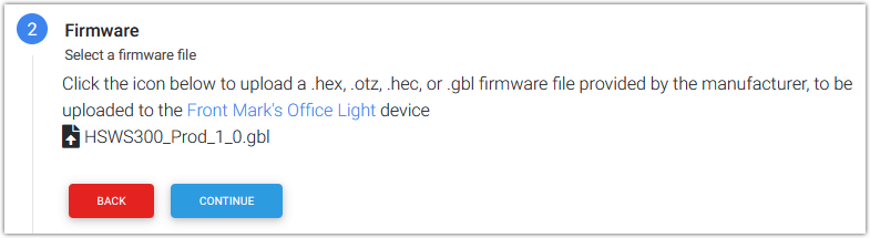

  3. On the Firmware step, click the Upload Firmware File button and select the firmware file from your computer. Then click CONTINUE.
