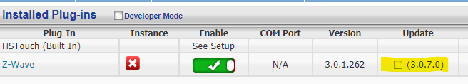

  3. Check the update box for your Z-Wave plugin

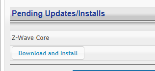

  4. Click Download and Install
  5. Once finish, you may need to restart your plugin by toggling the Enable off and back on.
