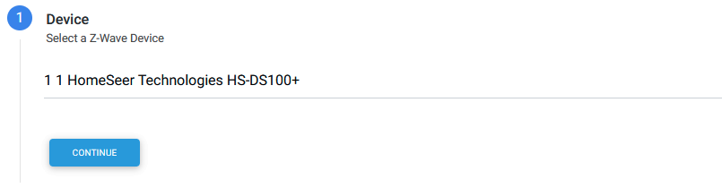

    1. In the Device step, select the device you wish to update and click CONTINUE

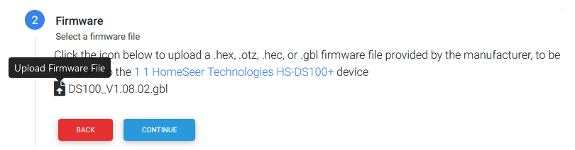

    2. In the Firmware step, click the upload icon button and select the firmware file you downloaded in step 1 and click CONTINUE

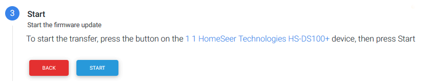

    3. In the Start step, click the START button to begin the update process and click the Z-Wave button on the device (if necessary).

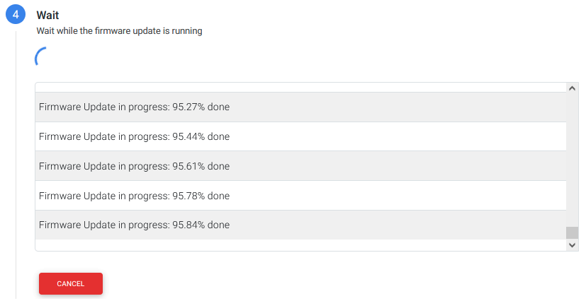

    4. In the Wait step, just wait for the process to finish. This can take a bit of time

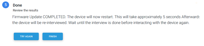

    5. In the Done step, click the FINISH button if the update was successful. If not, click TRY AGAIN and the stepper will repeat.
  4. After the update, be sure to test the device to ensure it’s working properly. In some cases, you may need to power-cycle the device by removing and restoring its batteries, toggling its air-gap switch or by unplugging and plugging it back into an outlet.
