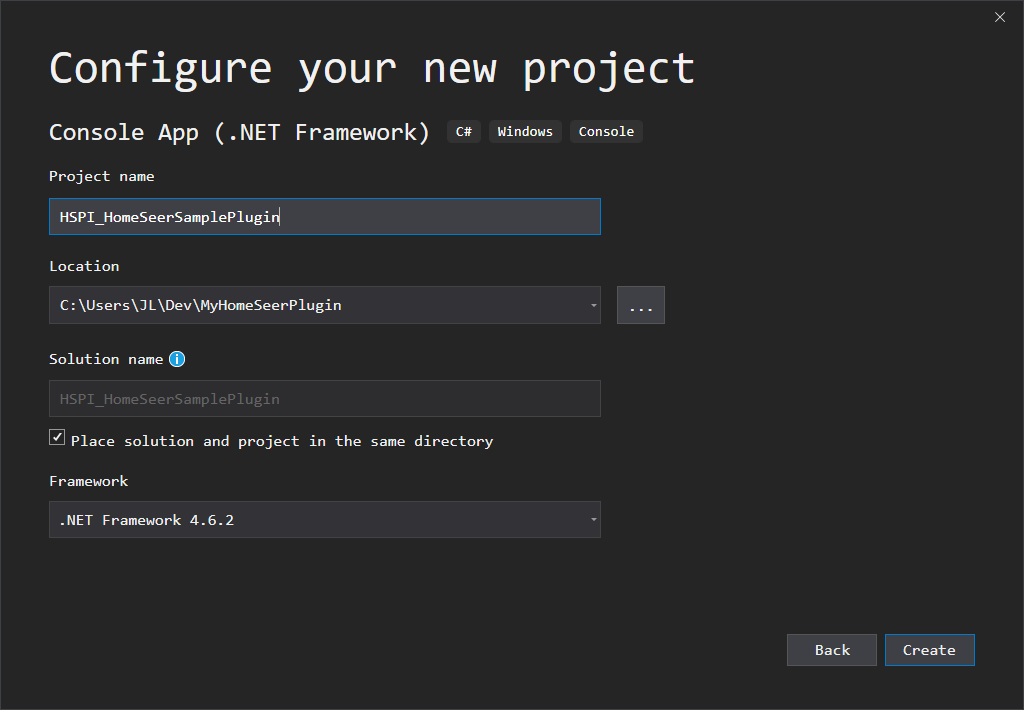

Create a new project
Create a new console app project targeting .NET Framework 4.6.2 in your choice of language. (Examples are provided in C# and VB)
The project's root namespace and assembly name must start with HSPI_
For example: HomeSeerSamplePlugin should be HSPI_HomeSeerSamplePlugin

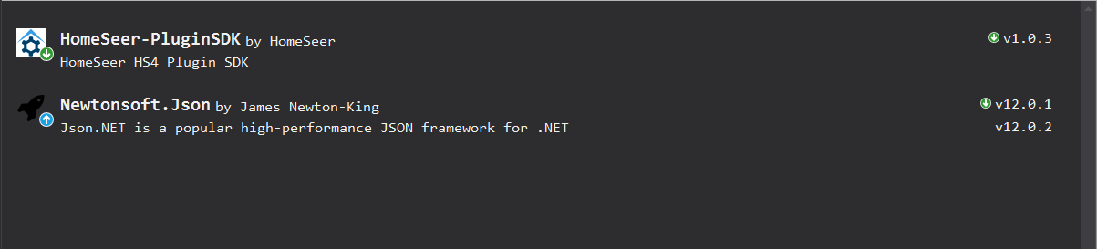

Add PluginSDK NuGet package
The PluginSDK is available through NuGet for inclusion into your plugin projects.
  1. Right-click your project in the Solution Explorer
  2. Select Manage NuGet Packages... from the menu
  3. In the Browse tab, search for homeseer pluginsdk
  4. Install the latest version of HomeSeer-PluginSDK to your project.
  5. Clear the search box and click the Installed tab
The list of currently installed NuGet packages for your project should look like this:
A list of installed NuGet packages showing HomeSeer-PluginSDK and Newtonsoft.Json packages.
In some older versions of Visual Studio, the default NuGet package source is not configured.  Make sure the following package source is configured: https://api.nuget.org/v3/index.json
