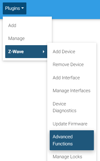

Access the Manage Interfaces page from Plugins > Z-Wave > Advanced Functions

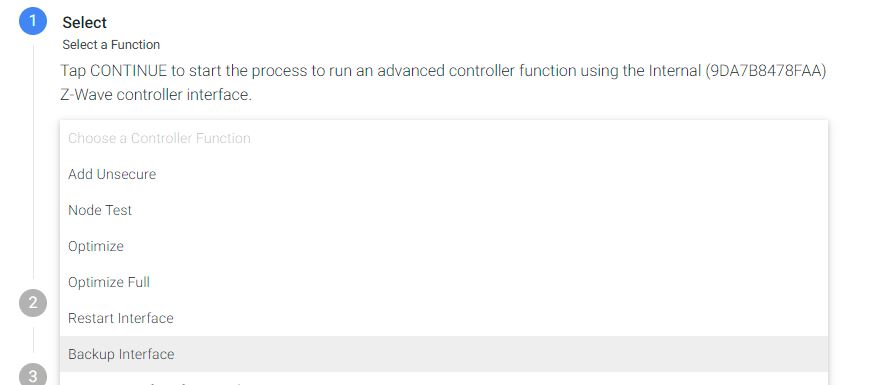

  1. From the Advanced Functions page, select Backup Interface in the drop-down menu, then click Continue.
