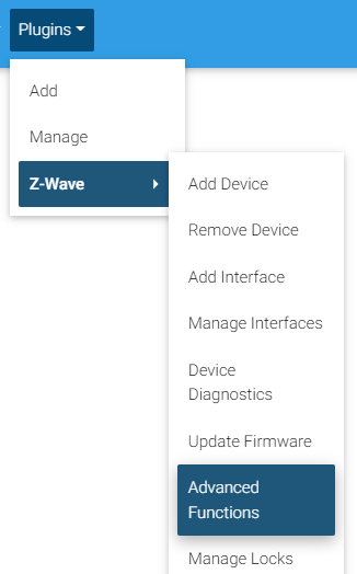

Access the Manage Interfaces page from Plugins > Z-Wave > Advanced Functions

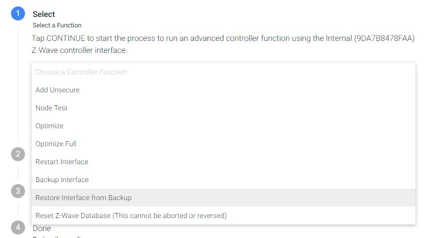

  1. From the Advanced Functions page, select Restore Interface from Backup in the drop-down menu, then click Continue.

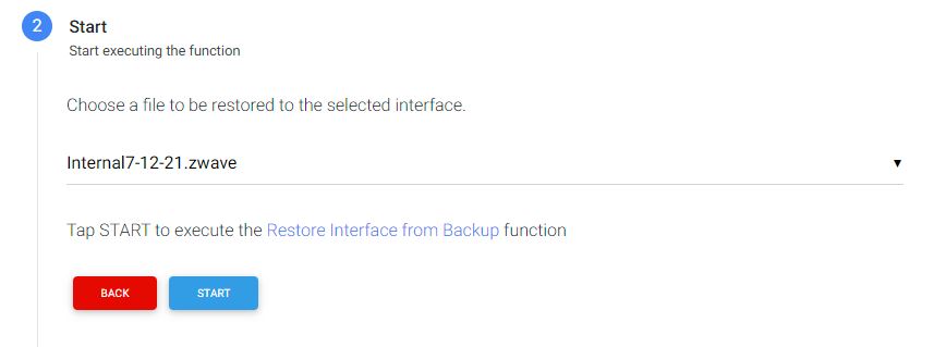

  2. You will be presented a drop-down menu to select a backup file to restore from. Unless there is a known good, older backup, we recommend selecting the most recent file, it should be time-stamped. Click Start.
