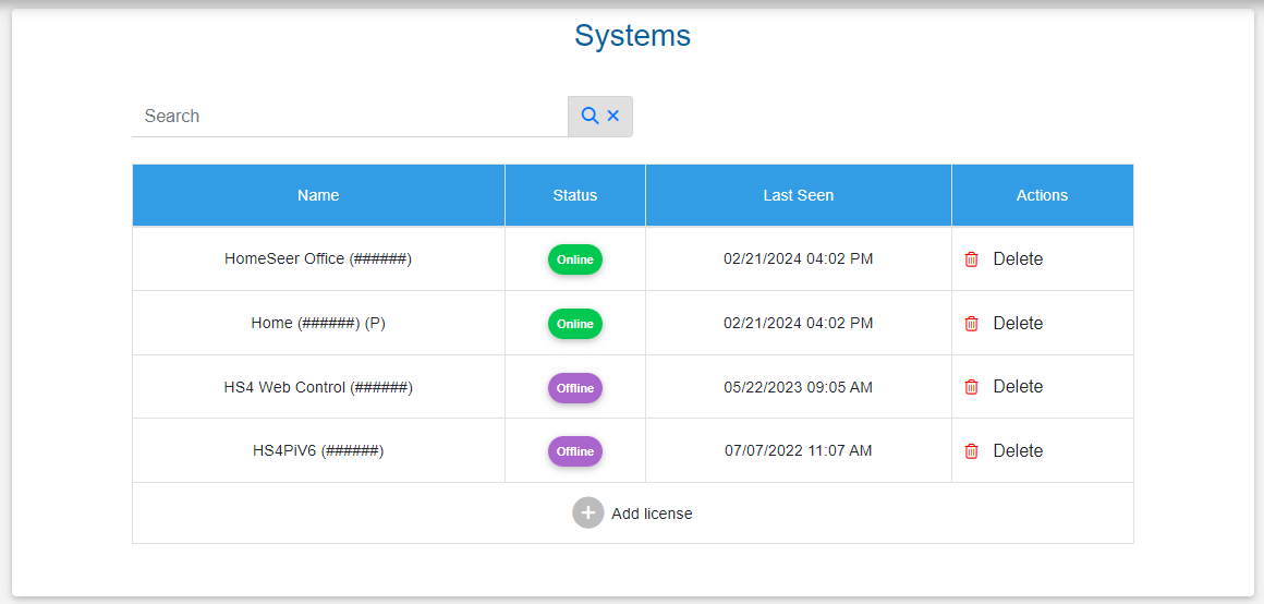

Adding Another HomeSeer System
If you are automating more than one location, click the Manage in the Systems section of the Dashboard, then click Add License and you will be prompted to enter the license ID and password for your other system. Once you do, you will see all additional systems under the Systems section of the account dashboard..

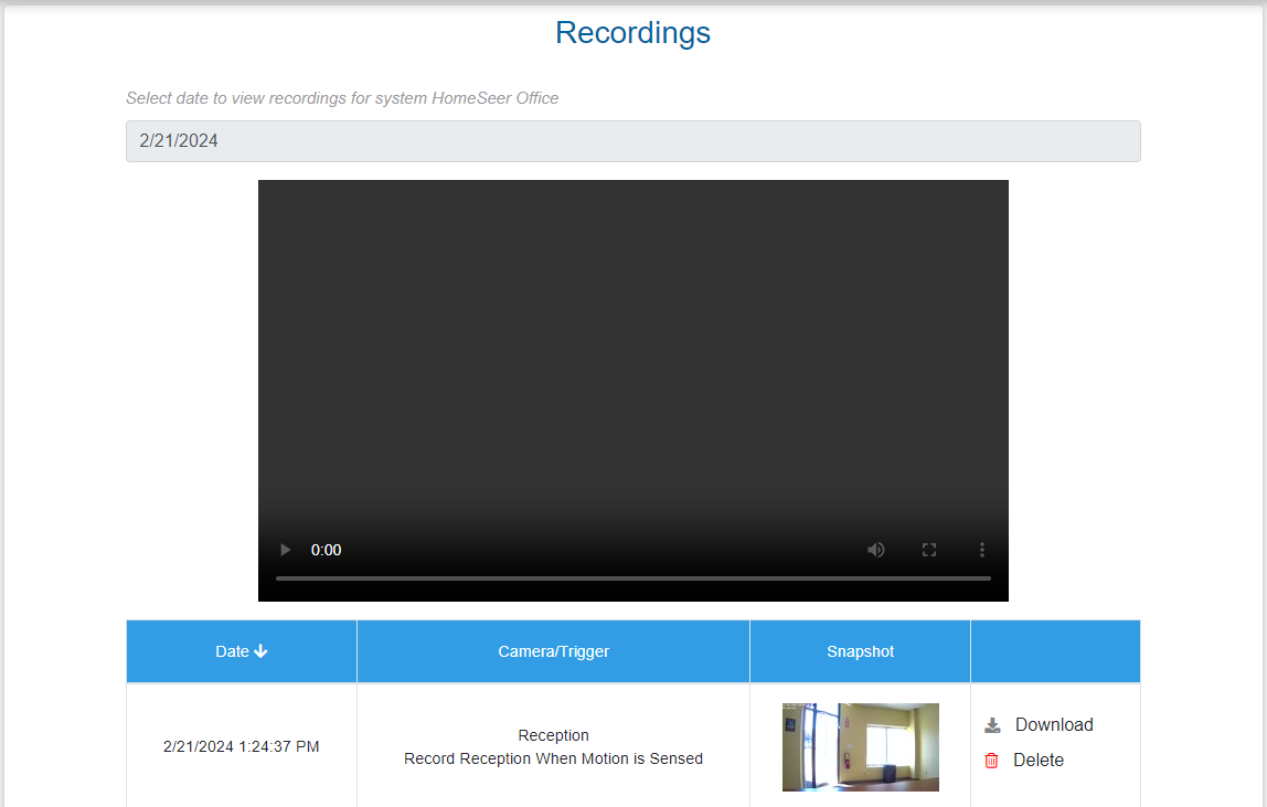

Managing Camera Recordings
After visiting myhs.homeseer.com entering your credentials, and clicking Log In, look at the Recordings section and you will see cameras which are connected to your system. If you have multiple systems on your account, click Manage to see a full list of them. There is a date selector at the top so you may review past recordings. Click the thumbnail for a recording to view it, or download it from this page.

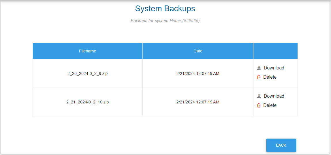

Managing Backups
After visiting myhs.homeseer.com entering your credentials, then clicking Log In, click Manage in the Backups section. Here, select the time and day of the month that you would like to have a backup saved from your HS4 system to the cloud.
Just below the Cloud Backup Schedule settings, you will find a list of systems which have backups available. Click on a system's name and a date selector will appear below the list of systems. Select a date when a backup was uploaded and you will be given the choice to download or delete it.
