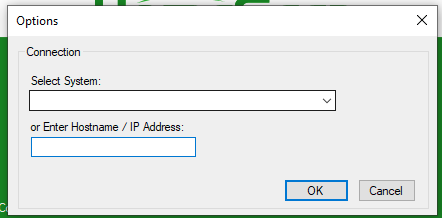

  2. Launch Z-Seer+ and you will be prompted to select your system by the window below.  The drop-down menu will display all systems present on your network. Alternatively, you can enter the host name or IP address.

  3. Launch Z-Seer+ and enter your HomeSeer system WAN IP address or Hostname into the connection options (as shown above).name or IP address.
