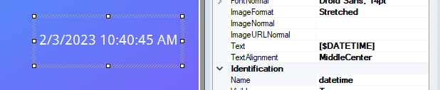

HSTouch includes a built-in function to display the current date and time.  To use this function, simply add a text element to the screen and enter the appropriate date and time variables in that element's text property (as shown below).
