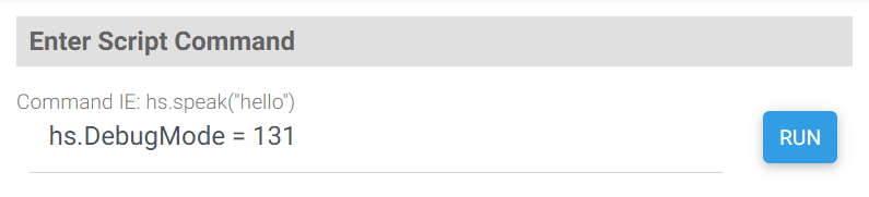

Debug mode can also be turned on from the the HS4 web interface by navigating to Tools > Script Commands and running the script command.
