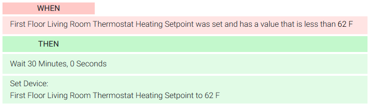

Example: Here's how the device features First Floor Living Room Thermostat Heating Setpoint  would appear in event triggers and actions:
