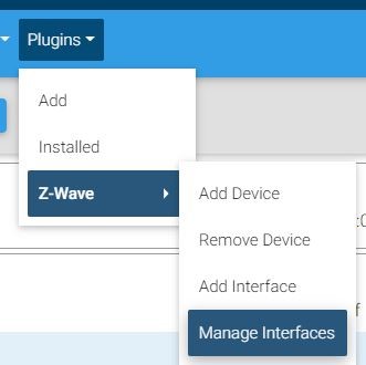

Navigation
Access the Manage Interfaces page from Plugins > Z-Wave > Manage Interfaces

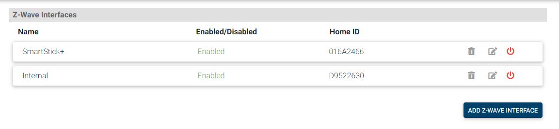

Editing Interfaces
An enabled Z-Wave interface has a red power icon and the buttons to edit or delete it are grayed out. To edit or delete an interface, click the red power icon and it will turn green.
- The trash icon will remove your Z-Wave interface from HS4. Note that this does not delete the data on your interface, so if you use this by accident then your device data will not be lost. Simply re-add your interface and your added devices will resume working.
- The edit icon will allow you to rename or change the communication port where HS4 will look for your interface. When moving a Z-Net to a new room permanently, it would be a good idea to rename it. It is not recommended to change the port of a working interface.

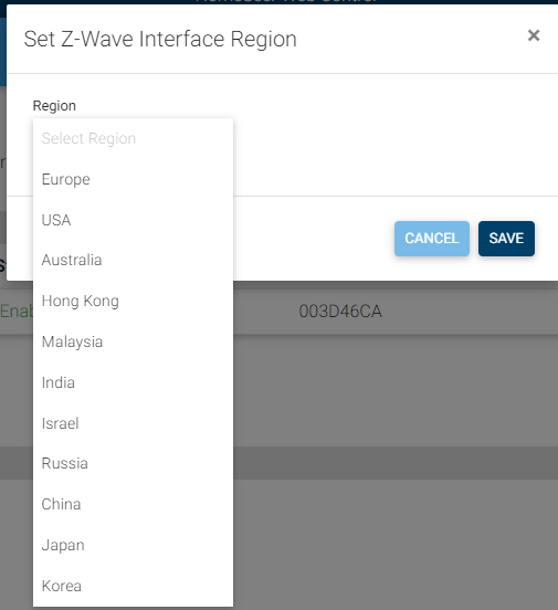

Changing Z-Wave Frequency
The HT-PI-G3, Z-NET-G3 and SmartStick+ G3 all allow for changing the frequency of the Z-Wave chip.
- Click the Set Interface Region icon.
- In the pop-up change the drop-down menu to the locale that matches the frequency necessary. (see the table below for frequency listings)
- Click save when finished.
