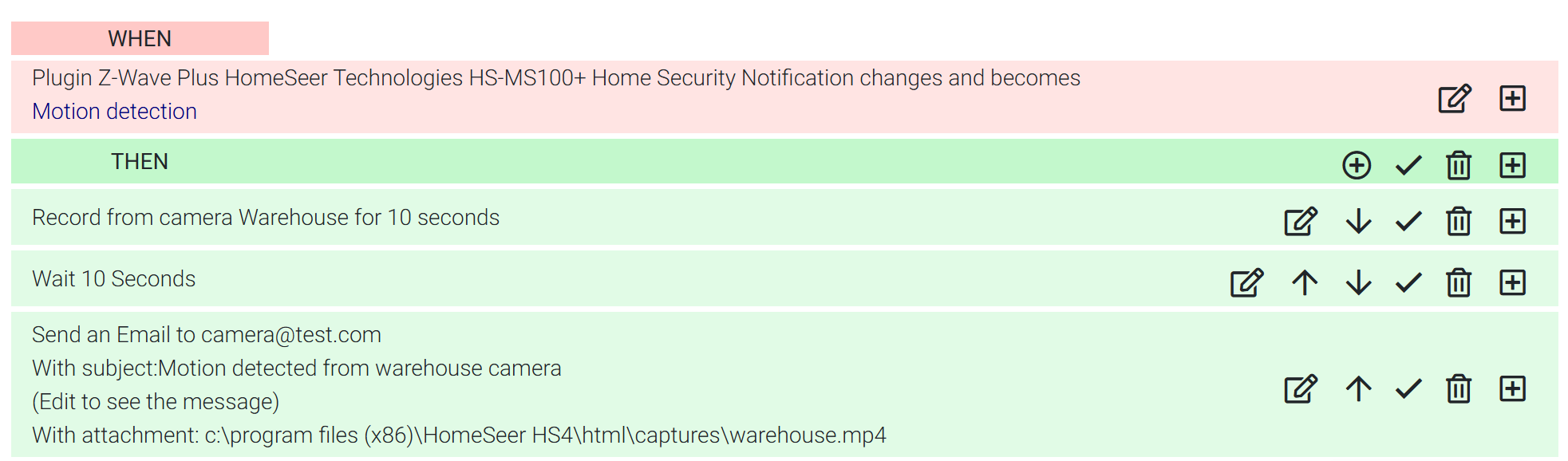

Emailing Recordings
Recordings are stored in the HomeSeer install folder in html/captures. If you would like to email yourself a recording, say after an event is triggered by motion and the action is record a video, add another action to send you an email and then add the recording as an attachment. Add the full path to the recording using the camera name. For example, if the recording was from the camera named "garage", enter the following paths:
For Windows, the default path would be (your path and drive letter may be different depending where you installed HS4):
c:\program files (x86)\HomeSeer HS4\html\captures\garage.mp4
For Linux based systems such as the HomeTroller Pi Hub:
/usr/local/HomeSeer/html/captures/garage.mp4
Note that the same file is overwritten whenever the same camera records a video so make sure you grab the file before another event attempts to record.
It takes a few seconds for the recording to complete once the record event action is executed so add a wait action for 10 seconds before the send email action is executed.
Here is an example event that will send a recorded video if a motion sensor detects motion:
Note: You will not be able to save this event if the .mp4 file does not exist. To create the file, go to the cameras page from the top menu bar and click on the record button.
