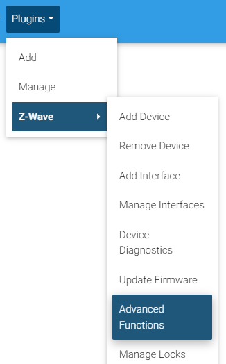

Access the Manage Interfaces page from Plugins > Z-Wave > Advanced Functions

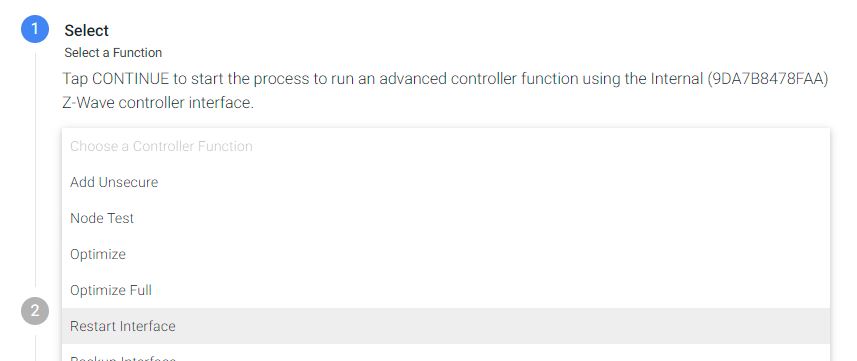

  1. From the Advanced Functions page, select Restart Interface in the drop-down menu, then click Continue.
  2. Click Start, then the system will log the actions performed while restarting your interface and move along to step 4 once it is complete. Press Details to review these logs if you like. Click Finish and you will be returned to the Devices page.
