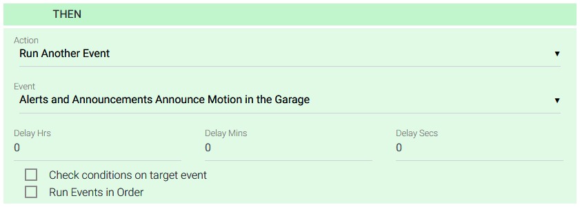

This event action is designed to execute the actions of another event within the current event. The action may be accessed by selecting Run Another Event from the action group menu. Simply select the event you wish to execute and enter a delay time (if desired). An option to Check conditions on target event will only run the target event if those conditions are also satisfied.
Example
Expanded
Settings
Setting
Description
Event
Choose the event you wish to run within this event
Delay (Hrs, Mins, Secs)
Enter the time to delay (if any) before running this action
Tick this box if you wish to ensure conditions in the target event are met before running the actions of the target event
Run Events in Order
Tick this box if you wish to run the target event actions first before and subsequent actions in this event
