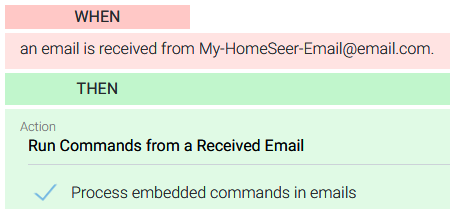

Run Commands from a Received Email
This event action is designed to control an device or execute another event when used with the trigger A Received Email... The action may be accessed by selecting Run Commands from a Received Email from the action group menu.

These commands should be placed in the body of the received email
