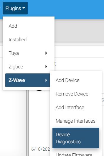

Access the Device Diagnostics page from Plugins > Z-Wave > Device Diagnostics

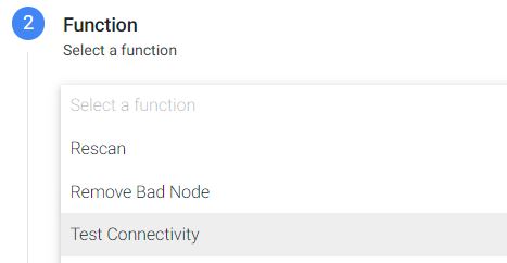

  2. The function drop-down menu will be open, select Test Connectivity, then click Continue.
