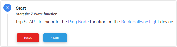

  4. Review the information in the Start step and click START.
  5. The Wait step displays any available information about the diagnostic process, then advances to Done. This may take some time or may happen in an instant.
