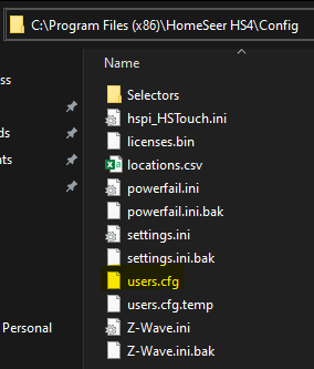

  3. Open Windows explorer and navigate to C:\Program Files (x86)\HomeSeer HS4\Config

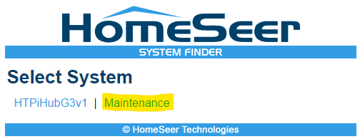

  1. Navigate to find.homeseer.com in a web browser
  2. Click on the Maintenance. Alternatively, you can simply add :911 to your systems IP Address image2022-4-28_13-19-23.png

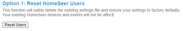

  4. When you see a message in your browser that it is unable to connect to your system, it is rebooting. Wait a minute or two, then navigate back to find.homeseer.com and select your Pi system.
