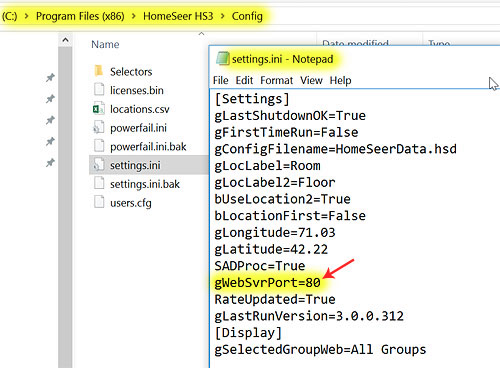

  2. Open your Windows File Explorer and locate the 'settings.ini' file in the HS4/Config folder. (C:\Program Files (x86)\HomeSeer HS4\Config)
  3. Open the settings.ini file with NotePad and change the gWebSvrPort port setting to '88' (or some other open port). If the gWebSvrPort setting doesn't exist, just create it as shown below.
  4. Save and close the settings.ini file and start HS3/HS4 again. The web server should work now.
