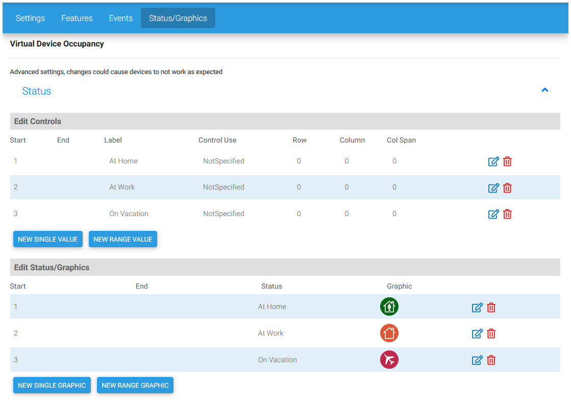

Step 2: Configure Device Status/Graphics

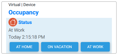

Step 3: Control Device
On the HS4 Devices page, click the plus button and select Virtual Device. Follow the prompts.
Access the Status/Graphics page and add 3 values with text and icons as shown above.
Click the 3 blue buttons to confirm that the text values and icons change status

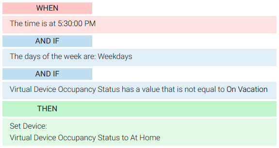

Event to Change Occupancy to At Home
This event fires at 8:30 AM on weekdays when you're not on vacation and sets the Occupancy device to At Work.
This event fires at 5:30 PM on weekdays when you're not on vacation and sets the Occupancy device to At Home.

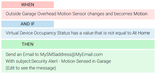

Event to Issue Alert When Motion Sensed and Occupancy NOT At Home

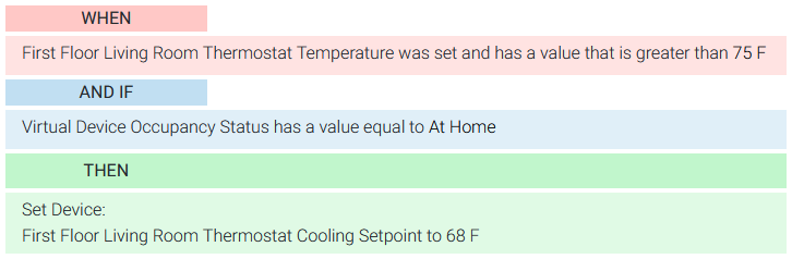

Event to Turn on the AC when Temperature Rises and Occupancy set to At Home
This event fires if motion is sensed at home when you're not At Home. So this will only fire if you're At Work or On Vacation.
This event turns on the cooling when the temperature rises but only if you're At Home. It will not fire if you're At Work or On Vacation.
