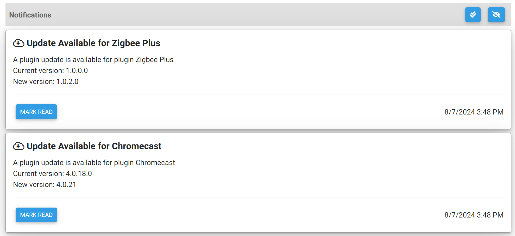

A notification trigger is generated when a new notification has been received. Notifications are generated by either the system itself, or from HomeSeer.
If a notification is available, a number will be displayed on the notification bell at the top of the page.
Clicking on the bell will display the notification page which lists the available notifications.
Options on this page:
  • Click the "Mark Read" button to hide the notification. If you need to get it back, click on the  image2024-8-12_14-10-45.png  icon. This will display all notifications, even notifications that have been read. Click it again to hide the notifications are marked as read.
  • To mark all notifications read, click on the  image2024-8-12_14-12-1.png  icon.
  • Notifications that have been marked as read will be permanently deleted 30 days after they have been received.
  • HS4 checks for new notifications from HomeSeer every 4 hours or if the notifications page is refreshed.
  • Internally generated messages using the "Create Notification" event action are displayed immediately.

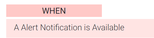

Alert Notification
Can only be generated by HS4. Alerts can be generated by the following events in the HS4 system:
  • A plugin fails to load
  • An HS4 event is created that generates a notification. See the "Create Notification" action.
