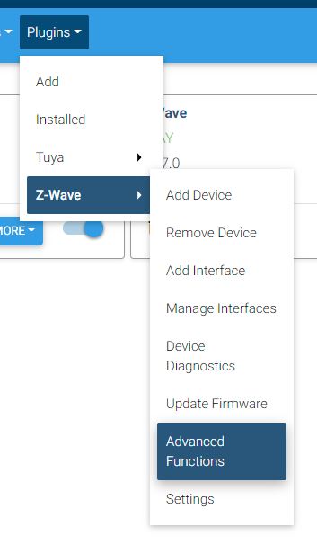

Access the Manage Interfaces page from Plugins > Z-Wave > Adva
ced Functions

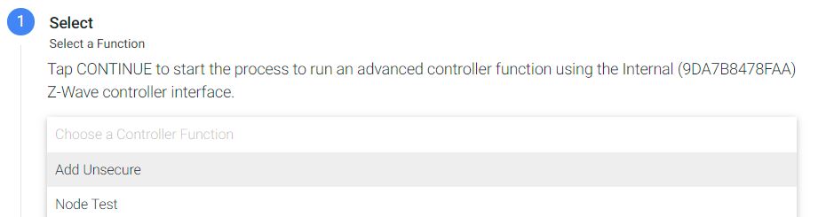

  1. From the Advanced Functions page, select Add Unsecure in the drop-down menu, then click Continue.
