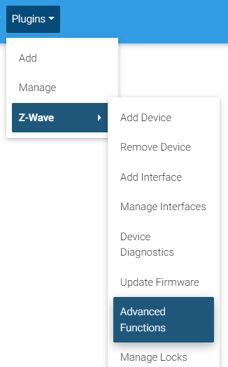

Access the Manage Interfaces page from Plugins > Z-Wave > Advanced Functions

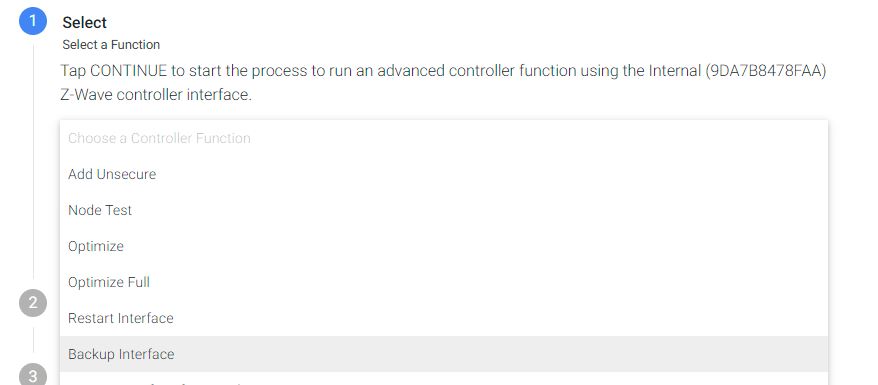

  1. From the Advanced Functions page, select Backup Interface in the drop-down menu, then click Continue.
  2. You will be presented a default file name for your backup including the network ID and date. Leave this as-is or enter a name that will be help you recall exactly which backup you are looking at in the future. Click Start.
  3. The system will log the process of creating your backup and move along to step 4 once it is complete. Press Details to review these logs if you like. Click Finish and you will be returned to the Devices page.
