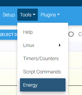

The Energy page can be accessed from Tools > Energy

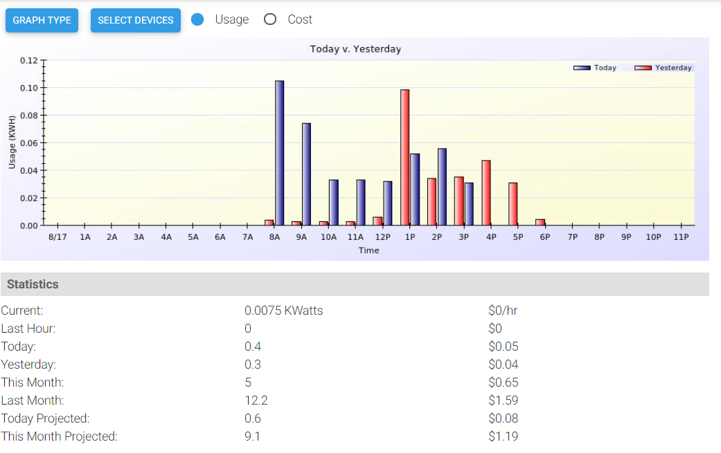

Reading the Data

When devices have reported energy consumption data, it will automatically be graphed out and the table filled out at the bottom. The axes are labeled for all graph types, and all values in the middle of the table are KW as reported form devices while those on the right are energy costs based on the cost of energy in your area.
