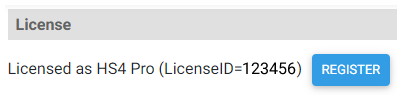

License
Click the REGISTER button to edit or change your license ID and password. This is useful when upgrading a trial license or moving from one edition of HS4 to another.

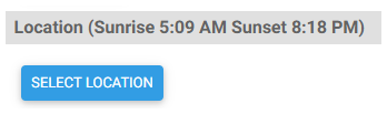

Location
This setting allows HS4 to calculate sunrise and sunset times for your system. Click the SELECT LOCATION button to select the worldwide location that's closest to your HS4 installation.
Alternately, you may manually enter your longitude and latitude for even greater accuracy.
