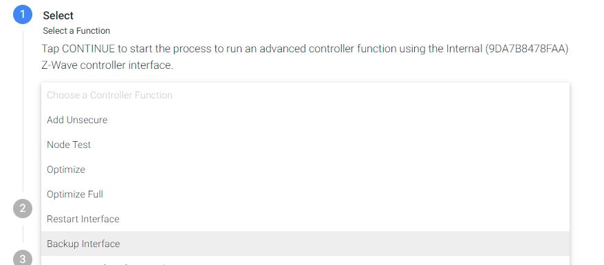

    1. From the Advanced Functions page, select Backup Interface in the drop-down menu, then click Continue.

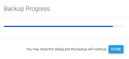

    2. Click the BACKUP NOW button and a small window will pop up within your web browser indicating that the backup process has been started and that the prompt can be safely closed.
    3. That is it! your system has now been backed up. If you would like to download a copy of your backup, click LOCAL RESTORE..., select a date, then the backup file and click Download.
