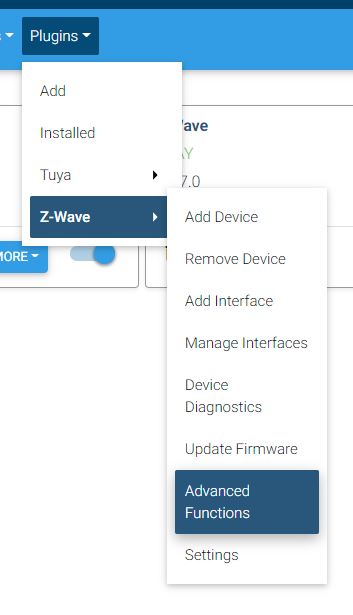

Access the Manage Interfaces page from Plugins > Z-Wave >
Advanced Functions

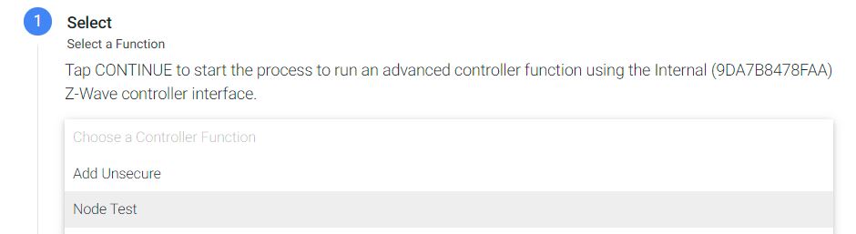

  1. From the Advanced Functions page, select Node Test in the drop-down menu, then click Continue.
  2. Click Start and the system will reach out to each node in your network and log the results. Once it is complete, it will automatically move along to step 4 where you can click Details to see those logs again. Click Finish to return to your Devices page or Run Another Function if you have more advanced Z-Wave functions to run. If you miss the logs on the Advanced Z-Wave Controller Functions page, you can also go to Tools > Log to review them.
