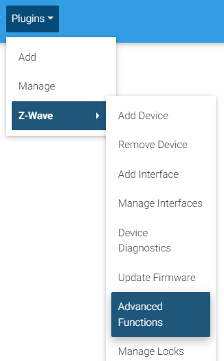

Access the Manage Interfaces page from Plugins > Z-Wave > Advanced Functions

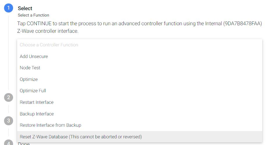

  1. From the Advanced Functions page, select Reset Data in the drop-down menu, then click Continue
  2. Click Start, then the system will log the actions performed while resetting your Z-Wave data and move along to step 4 once it is complete. Press Details to review these logs if you like. Click Finish and you will be returned to the Devices page.
