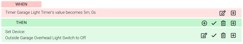

Timers
In this example, a garage light is turned off when a timer reaches 5 minutes. The timer itself can be controlled by another device, like a motion sensor, restarting every time motion is sensed. The net effect is that light will remain on in the garage until 5 minutes after the last motion is sensed.

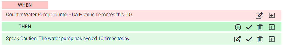

Counters
In this example, a spoken alert is issued when a water pump counter reaches 10. The counter can be controlled by energy sensing outlets or smart plugs.
