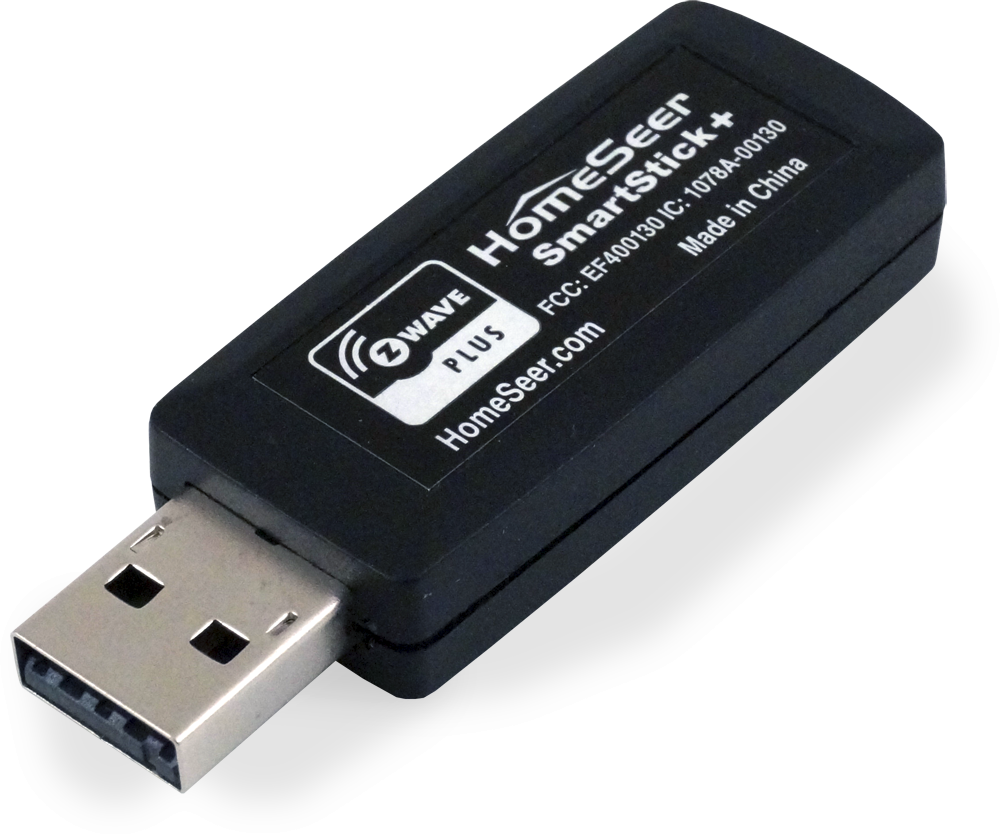

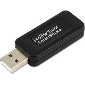

SmartStick+ (HUSBZ-2)
FW: v4.32
SDK: v6.51.6

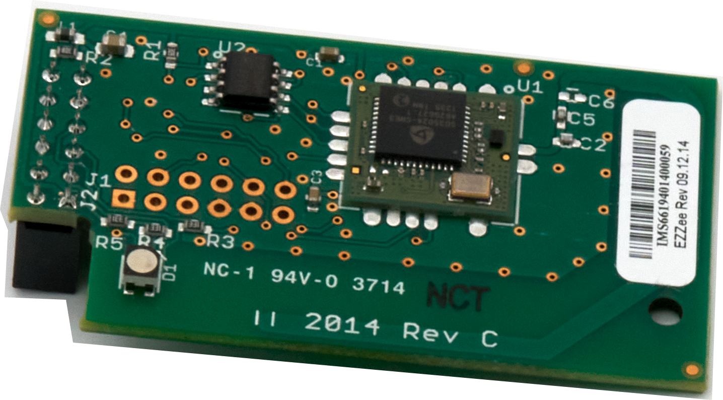

Z-Net/HomeTroller Zee S2 (EZZeeUS Rev C)
FW: v4.31
SDK: v6.51.6
with barcode sticker

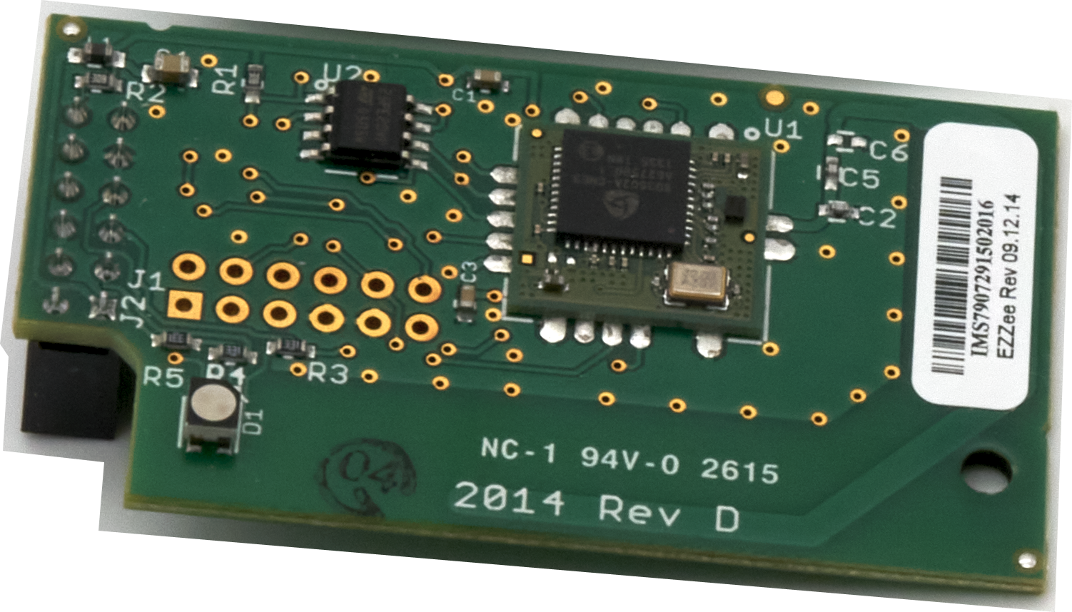

Z-Net/HomeTroller Zee S2 (EZZeeUS Rev D)
FW: v4.32
SDK: v6.51.6

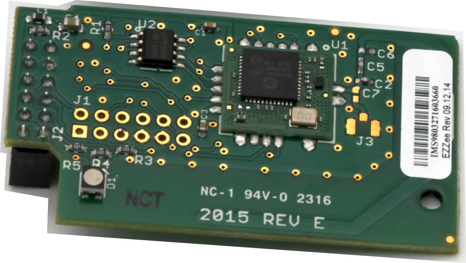

Z-Net/HomeTroller Zee S2 (EZZeeUS Rev E-S)
FW: v4.32
SDK: v6.51.6

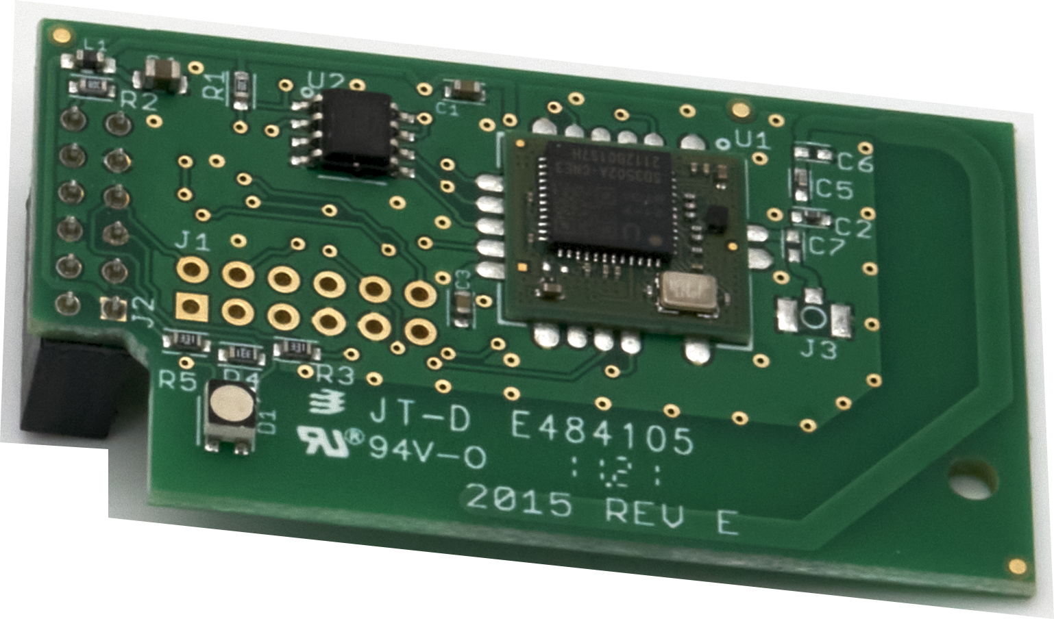

Z-Net/HomeTroller Zee S2 (EZZeeUS Rev E)
FW: v2.8
SDK: v6.81.1
no sticker

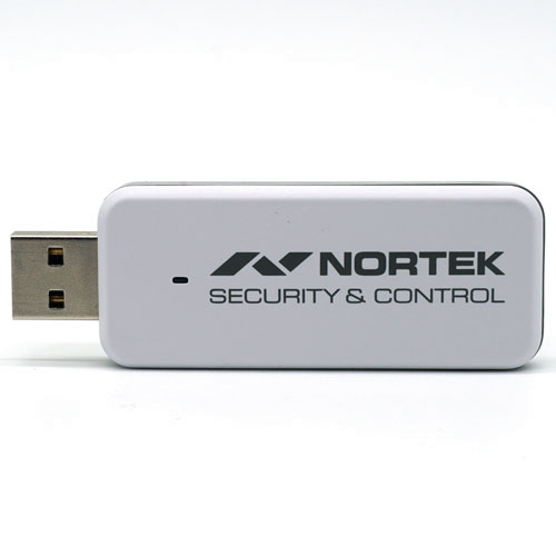

Nortek HUSBZB-1
FW: v4.32
SDK: v6.51.6

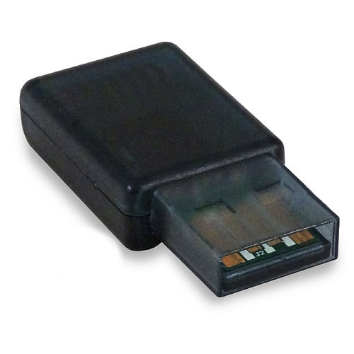

Z-Wave.Me UZB
FW: v5.5
SDK: v6.51.6
The Rev version of the interface on the Z-Net and HomeTroller Zee S2 is printed on the Z-Wave HAT (Hardware Attached on Top). The hardware will need to be disassembled to see this information.

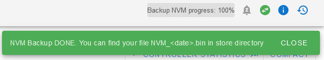

  3. Find the NVM Management action, click the BACKUP button and click OK to begin the backup. This may take a few minutes to complete. When finished, an NVM_<date>.bin backup file will be generated and saved in your store directory or downloads folder.
