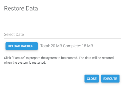

    2. Click the RESTORE... button, then UPLOAD BACKUP... in the resulting pop-up.
    3. HS4 will now open the file manager on your computer. Locate and select the backup zip file on your computer and click Open.
    4. Once the upload is complete, click the circle to the left of its name, then EXECUTE.

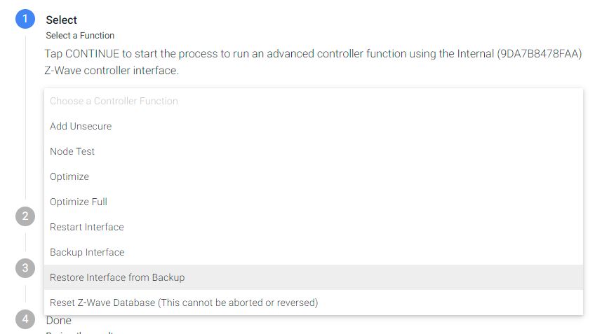

    1. From Plugins > Z-Wave > Advanced Functions, select Restore Interface from Backup in the drop-down menu, then click Continue.

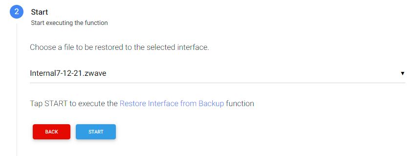

    2. You will be presented a drop-down menu to select a backup file to restore from. Unless there is a known good, older backup, we recommend selecting the most recent file, it should be time-stamped. Click Start.
