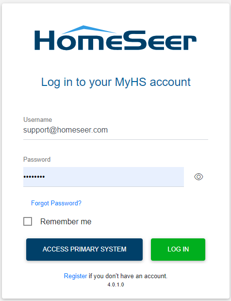

  1. Visit
    myhs.homeseer.com
    , enter your account credentials and click Log In.

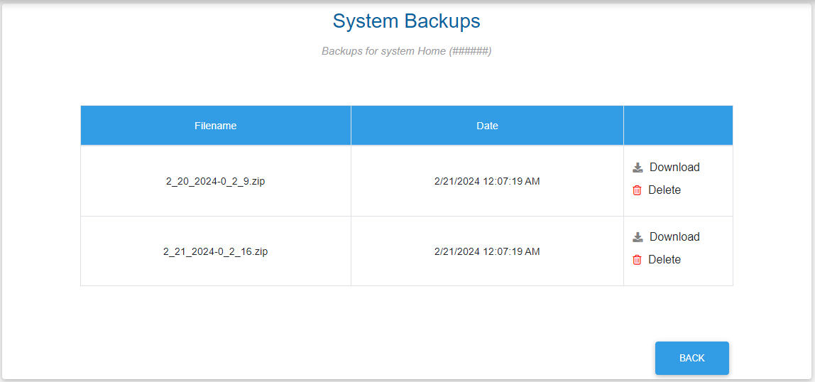

  1. Once your cloud backups are configured and created, you can see them by visiting myhs.homeseer.com, entering your credentials, then clicking Log in.
  2. Click Manage in the Backups section and you will be shown a list of your systems which have backups available. Click the name of one of your systems and a date selector will appear below. Select a date when a backup was uploaded, then click OK.
  3. Downloading a backup will save it to the computer you are using to view the MyHS web page with. Please see our guide on How to Restore a Backup for information on restoring it to HS4.
