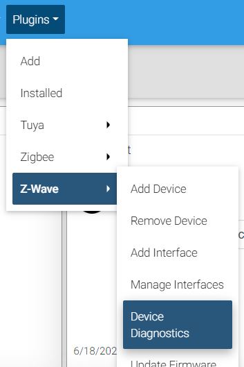

Access the Device Diagnostics page from Plugins > Z-Wave > Device Diagnostics
